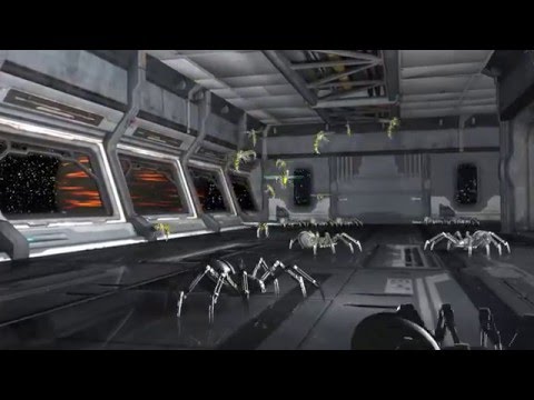

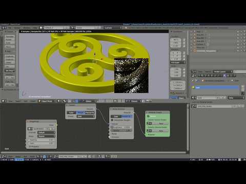

Here is a video of LuxusCore doing its thing.
-> http://www.youtube.com/watch?v=dNJoPLQ2QNE

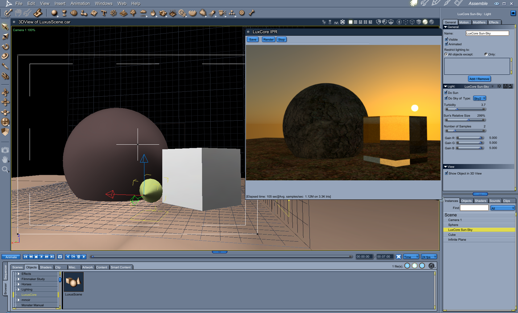

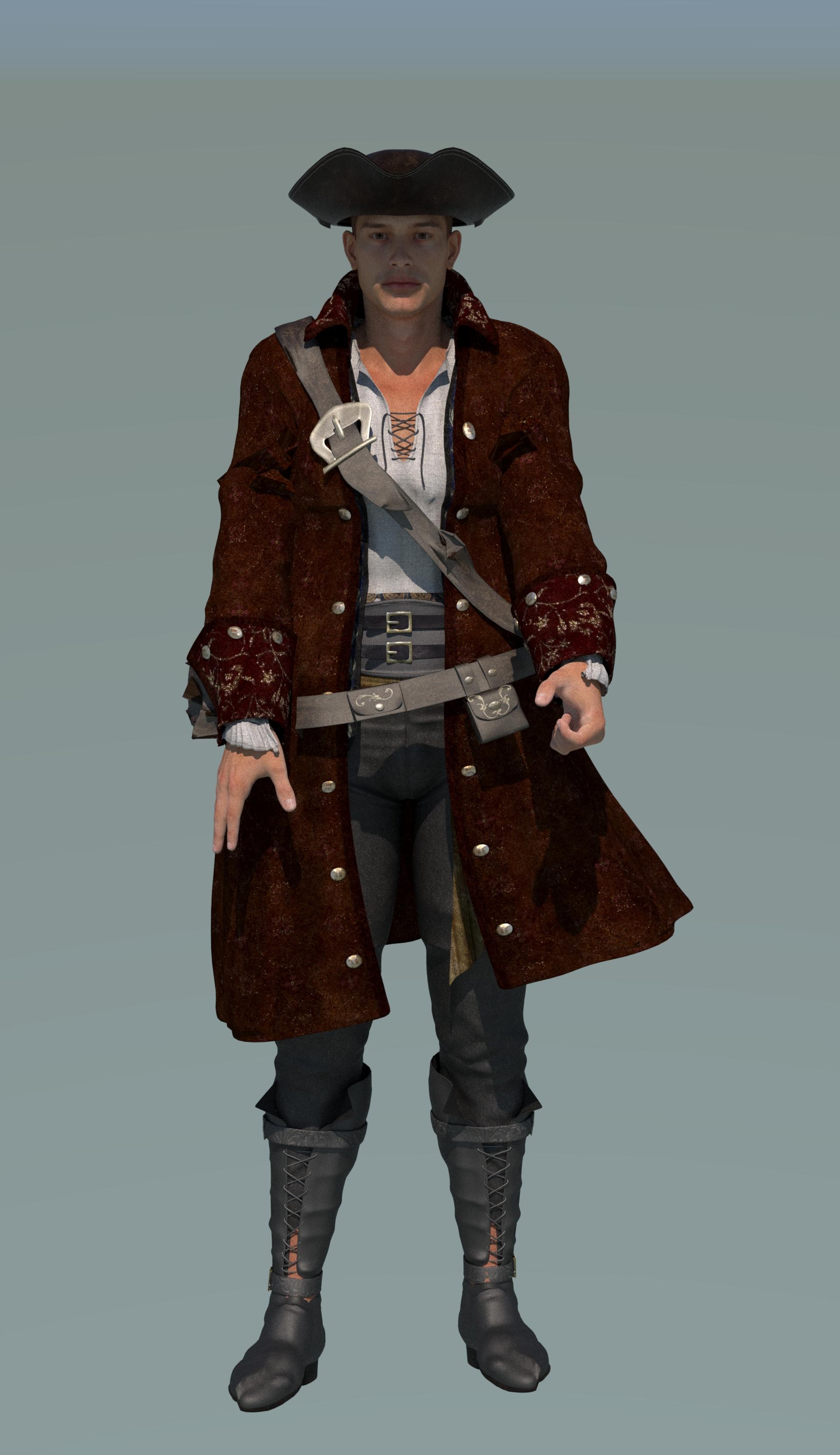

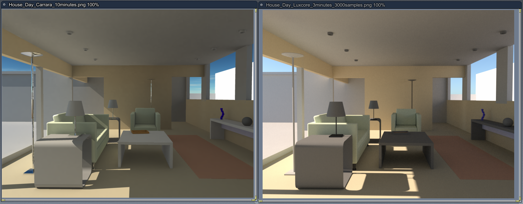

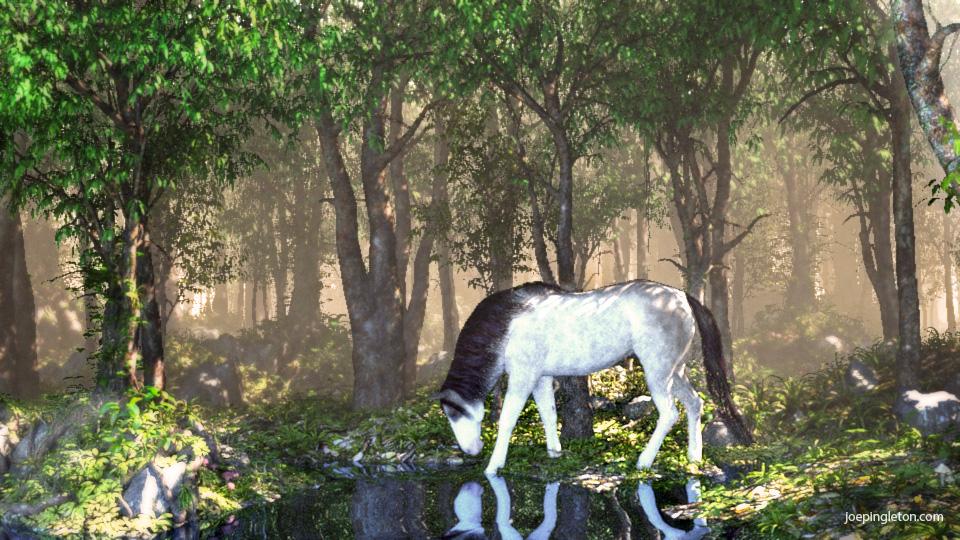

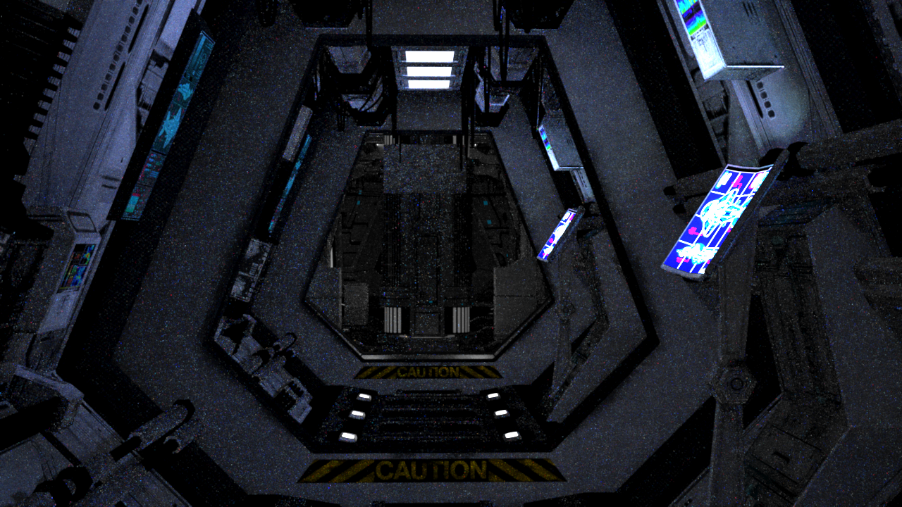

  • SphericLabsSphericLabs Posts: 598
    If it can be used for animation, it sounds as if Sci-Fi Funk may have another tool in his arsenal. Does replication work better in Lux (as an abbreviation) than it reportedly does in Octane? By that I mean, from what I have read, Octane can replicate, but not replications of replications, meaning in theory you couldn't replicate a forest of Carrara trees as the trees use a replication method to generate the leaves.

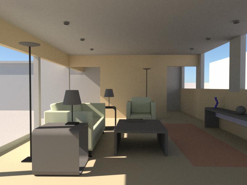

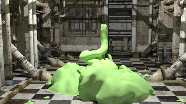

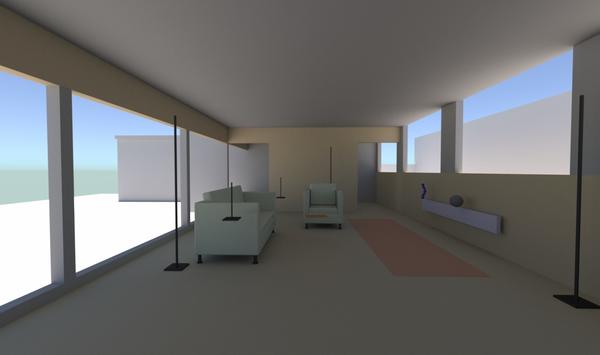

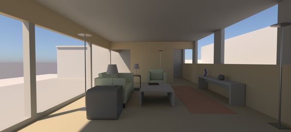

    Replicated replication seems to work.
    1791 x 1028 - 2M

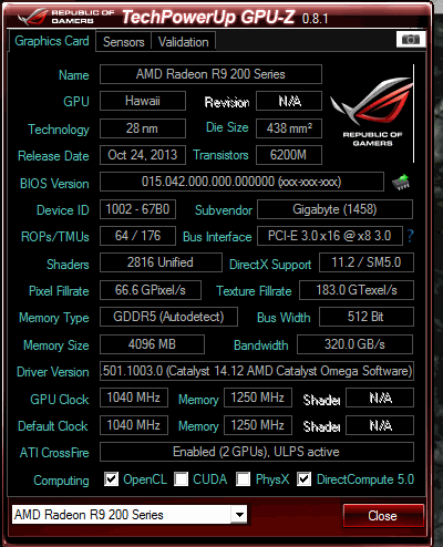

  • DustRiderDustRider Posts: 2,904

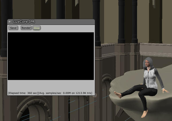

    Looks great!! I downloaded and installed, but haven't been able to get it to work yet, It mostly just crashes to the desktop. I'm guessing that I'm just missing an important step, or maybe I need to add something into the configuration text box to exclude a GPU (I am using a laptop with "two" GPU's, the integrated Intel, and an Nvidia 670M).
    I installed LuxusCore in the extensions directory in a folder called LuxusCore (just copied the folder from the unzipped file)
    When I open Carrara I start with a blank new scene, insert a ball, delete the default light, and add the LuxusCore infinite light. I change the renderer to LuxusCore. At this point if I open the LuxusCore IPR Carrara crashes. If I change the material on the ball to a LuxCore material (just at the top level), then start LuxusCore IPR Carrara doesn't crash, but I get a blank IPR window with an error message at the bottom of the window about an unknown material (changing the drop down from Stop to Render has no effect on the blank window). If I change the material to Luxcore Matte I get and error message stating there is no light source in the scene (even thought a Luxcore infinite light is in the scene). Now if I delete the Luxcore infinite light (with IPR closed), then add the Luxcore Sky Light, when I start the IPR Carrara creashes to the desktop.
    Any ideas as to what I might be doing wrong would be greatly appreciated (I've watched the video several times, but I may have missed something simple).
    Thanks in advance!
    edited December 2014
    Thanks in advance!
    Experimental. I suspect it is probably choosing your intel card as opposed to the NVDIA one.
    Perhaps a scene I know works for me would be helpful.
    -> http://sphericlabs.com/scratch/LuxusScene.zip
    Also you can render in the regular Carrara way. Ctrl-R or clicking render, you just can't make edits as it renders.
    Thanks in advance!
    Thanks for the quick response!
    Unfortunately this scene crashes in both C8.1 and C8.5. It may be selecting the wrong card, or both?
    dustrider said:
    Thanks in advance!
    Hmm. If you don't mind trying the following:
    - Load that scene.
    - put the following line into the Config Settings:
    opencl.devices.select = "01"
    - click render button, not IPR
    If that does not work, how updated are you video drivers? NVIDIA has improved OpenCL support alot lately.

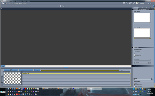

    - Load that scene.

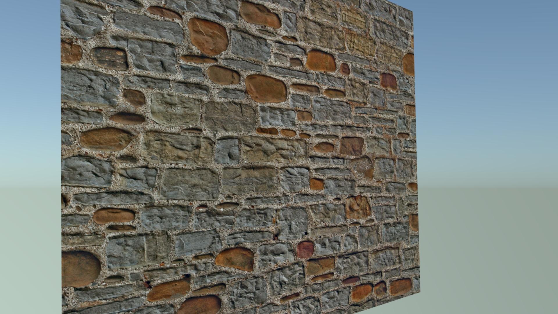

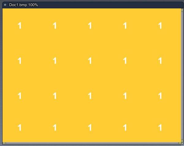

    Carrara didn't crash, the render I got (just a bunch of 1's) is attached. The Nvidia drivers should be the latest (or close - 344.75), I updated them a couple of weeks ago to support the latest version of Octane.
    - Load that scene.
    I should have added that Carrara crashes when hitting the render button without the line added to the Config Settings.
    dustrider said:
    - Load that scene.
    Hmm maybe try this in the config settings:
    renderengine.type = PATHCPU

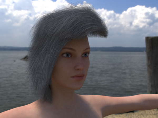

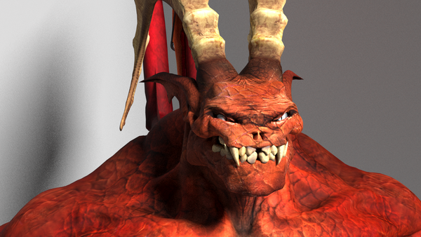

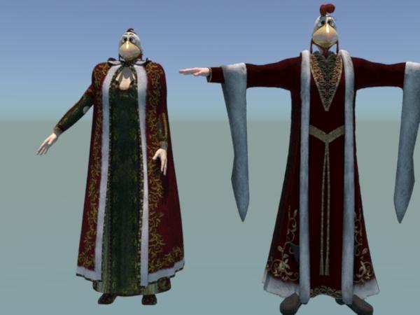

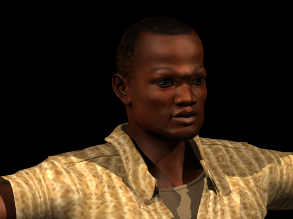

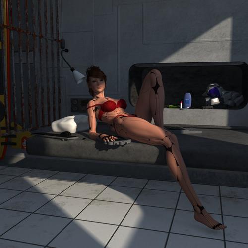

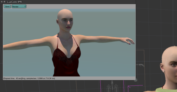

  • JoepingletonJoepingleton Posts: 746

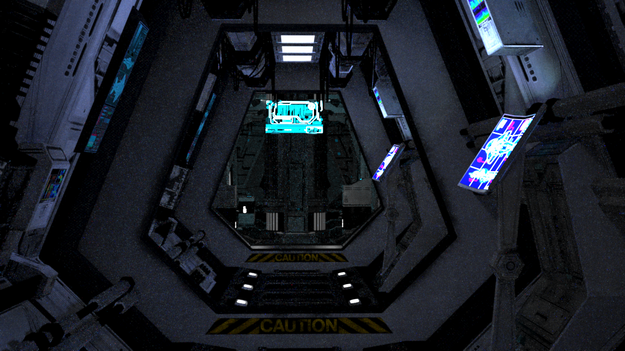

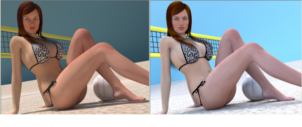

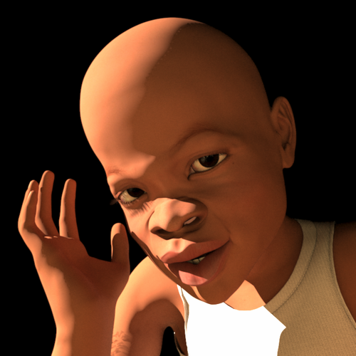

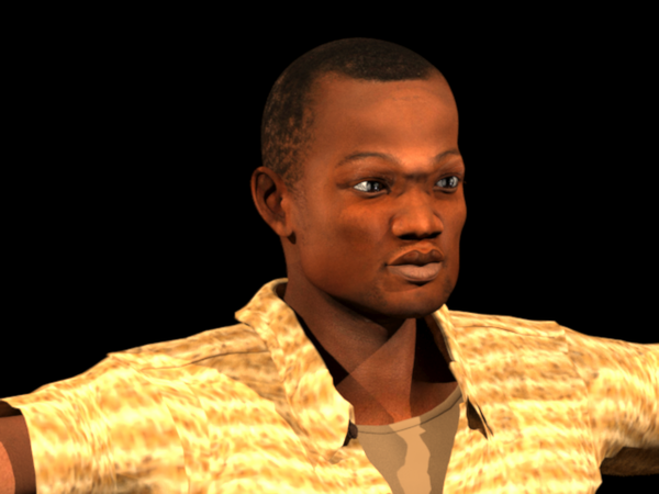

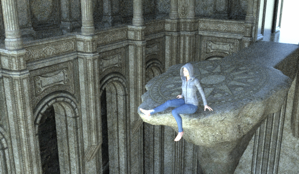

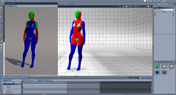

    After playing with this a little I ran into something strange.
    It seems to work great at lots of things, but when I tried it on a Genesis figure I started to get strange results.
    I made some simple textures for the limbs, face and torso and when I try to render it seems to mix them up. Attached are some quick samples.
    Any ideas on what might cause this?
    1920 x 1044 - 895K
    1920 x 1044 - 855K
    Post edited by Joepingleton on
    Not off the top of my head. I will certainly fix it.
    Does it do the same when you Render using LuxCore, as opposed to IPR?

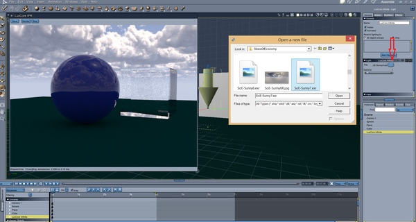

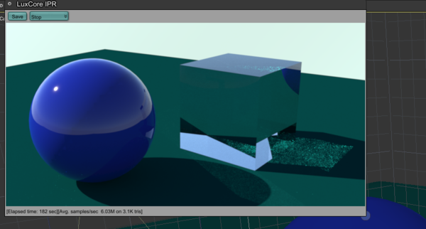

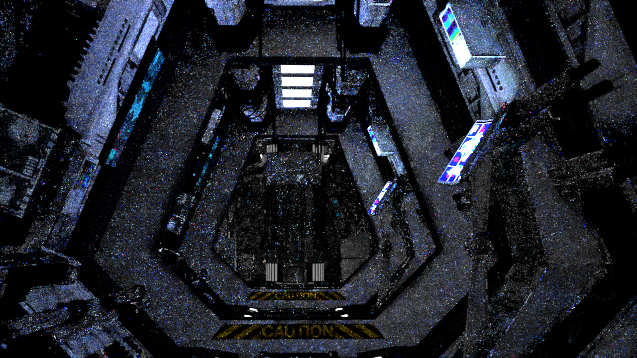

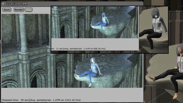

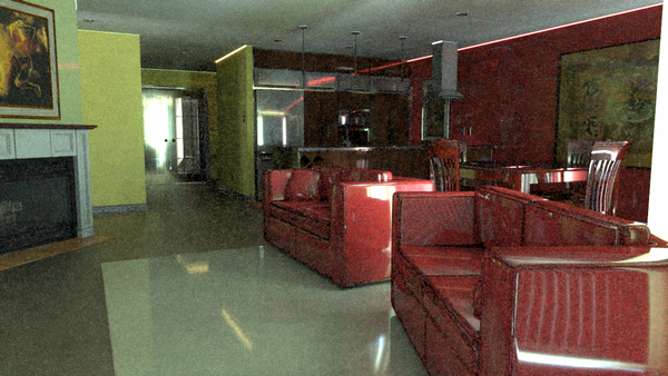

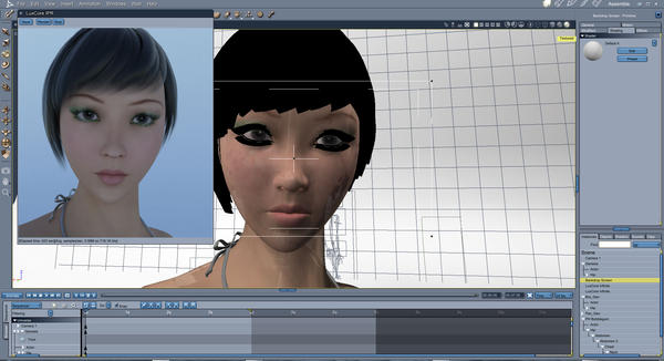

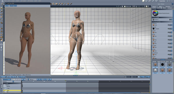

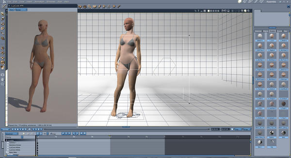

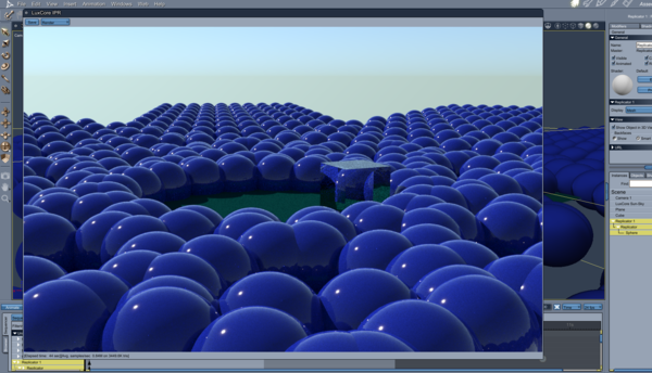

  • MythmakerMythmaker Posts: 606

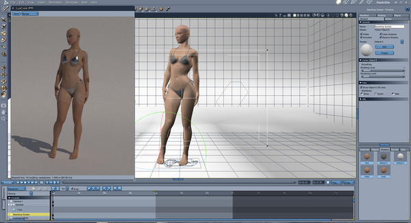

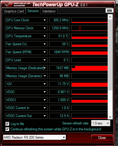

    Good to see IPR possibility in Carrara. Replication of replicator sounds good.
    Xeon 5670 12GRAM Titan.

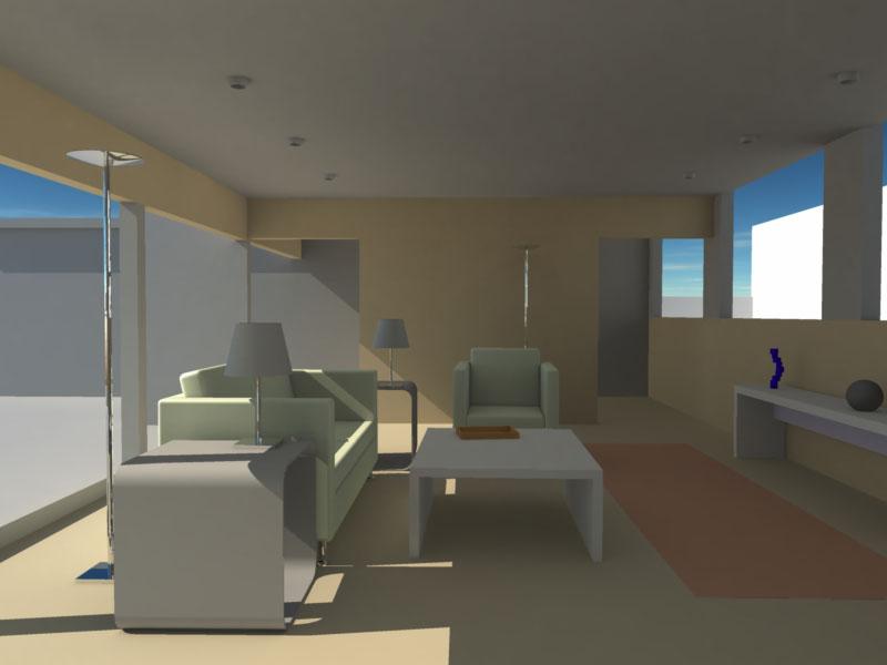

    Fumbled around at first, hit and miss. When IPR didn't behave (I didn't load Luxus Surface at first), native Render Ctrl R does work sometimes. Decided to keep it simple. Only focusing on testing iPR.
    Loaded LuxusSxene.car afresh. Works as expected with no tweaking. Nice caustics, fireflies banished around 3 minutes.
    Loaded Genesis basic female next. Skin seems too bright. Delete Light 1. Add Luxcore Infinite, same bright skin (dark red dress was bright but still closer to normal). Switch to Luxcore Sun Sky. Works.
    CPU fan started going immediately (at Reality4 rate). I was hoping that this LuxusCore is leaning towards GPU.
    My hope is LuxusCore IPR has Daz Studio style AuxVeiwport with complete 3D navigation tools, and render and stop are separate buttons. Animation friendliness would be really really cool, a very wanted feature this season.
    Keep up the good works!
    860 x 462 - 214K
    970 x 503 - 177K

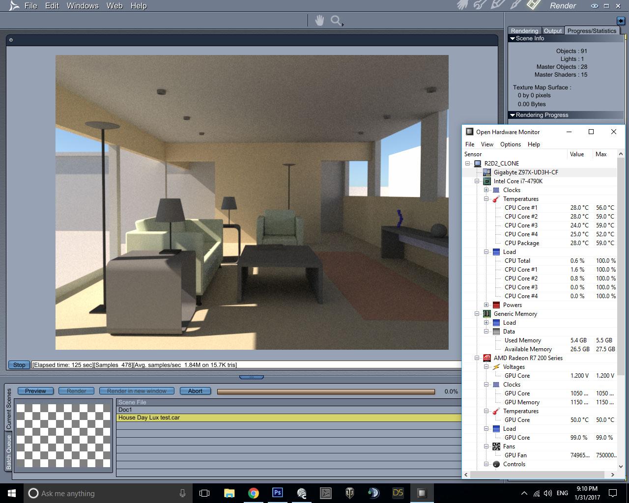

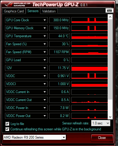

    I use OpenHardwareMonitor to see what my GPU load is and it always is pegged at 99% when I render, of course I don't have a Titan. 5.5Million samples per second on 3/4 million triangles seems really good to me.
    The IPR window is constantly refreshing so try rendering with the Render button. Also using the Render button you can try the following "config settings" which should turn off using cpu for rendering:
    opencl.cpu.use = 0
    But I think that is the default.
    That worked! So that narrowed it down to a GPU problem, and no doubt the integrated Intel GPU (Intel 4000). Unfortunately on this system I can't disable it.
    I ran accross this post which shows how to disable the integrated GPU with Luxcore (http://www.luxrender.net/forum/viewtopic.php?f=34&t=11317&start=20), I tried using the values shown with the fist config statement you gave me (opencl.devices.select = "01"). With the value set to 010, Carrara crashed. With the value set to 100, Luxcore worked (woohoo), but it was about half the speed of the render using renderengine.type = PATHCPU (0.84M vs 1.4M) , and all four cores on the CPU were maxed as well (odd - I'm guessing this was the integrated GPU). With the value set to 001, I got what looked like the proper GPU, rendering at 2.14M s/s with no associated spike in the CPU activity (WOOHOO!!!).
    Of course this is in the Render Room, and IPR still crashes. Maybe it will help with configuring the IPR (or possibly the IPR could use the congig setting in the render room?).
    Of course, because the CPU counts as an OpenCL device. Good job, that does help. I think lots of people will have 3. I will get a way to configure the IPR devices. Probably should disable the intel one by default if an AMD or NVIDIA one exists.
    Thanks for the new build.
    I still get the same problem when I use a luxcore texture on a genesis figure (either LuxCore or IPR).
    Interestingly I don't get the problem using the basic genesis textures unmodified. Sample attached.
    1920 x 1044 - 864K
    I tried the same thing as you and it worked. Would you mind sending me the scene, the color blocked one. PM or something?
    Thanks,
    I sent you a pm, It's probably that I don't know what I am doing, since that is my normal problem :)
    joeping said:
    Thanks,
    Its my bug. The 5_Eyelash did not have a shader, so the Shading Domains are shifted. I will fix it, but for now make sure every Shading Domain has a shader.
