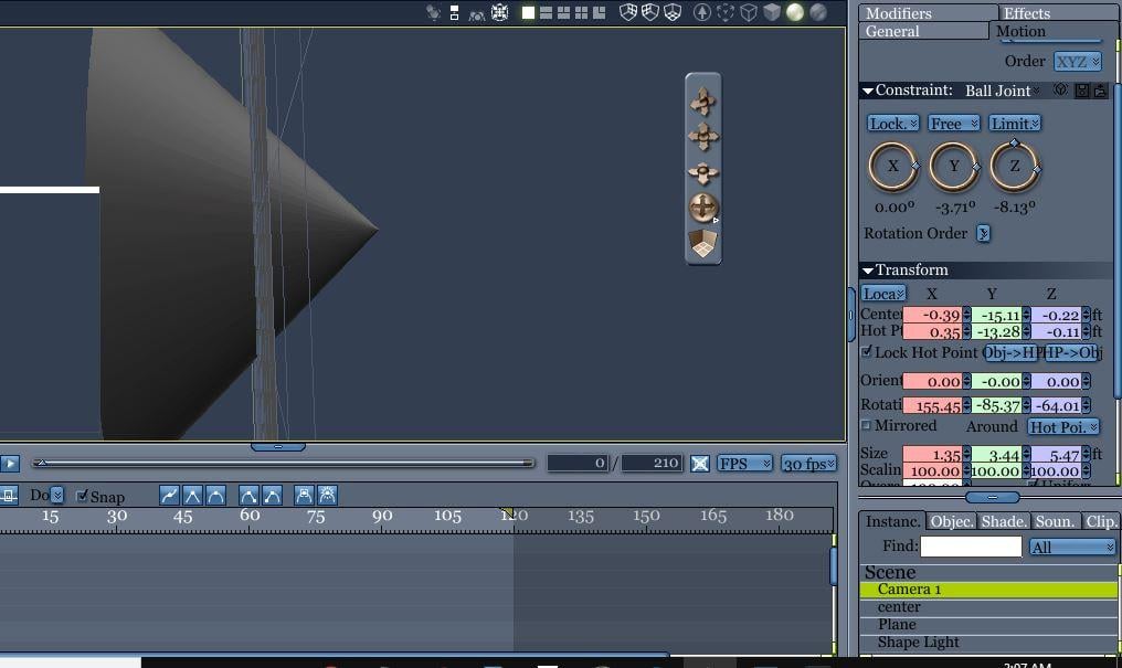

Constraints?
the constraints is confusing
trying to limit constrains on camera movement.
was guessing rotate limits would be ball joints?
wanted to lock the x rocking.  limit tilt up n down by 45/-10 degrees.
but not locking the zoom in and out. and not lock the frame by hitting 0.
my efforts are locking everything but the tilt. with ball joint on, 0 doesnt work.  cant scroll in.
is my machine possessed?

     Dont have collison detection on perhaps?
  • DartanbeckDartanbeck Posts: 22,162
    Also keep in mind that, "Zooming In" with the mouse wheel moves the camera toward the target. So if it's locked you'll need to select the camera and adjust the zoom in the instances tray.
    noticed you have lock children checked - maybe that locks something

    here try this its a custom constratint - you can zoom up and down on the z axis - i parented the camera to a verex object - just move the object not the sphere
    probably would work straight in the camera
    one needs to be a cbr = so change from zip to cbr - that is the constraint file
    to use select your camera and select motion custom constraint and load it up (icone next to save icon)
    the other is the car file - change suffix to zip
    EDIT almsot works - have a play with the custom constraints

    thanks.  know it souns silly, but i keep flipping the scene upside down
    or i'm wheel scrolling, not realizing cursor is in the numbers boxes

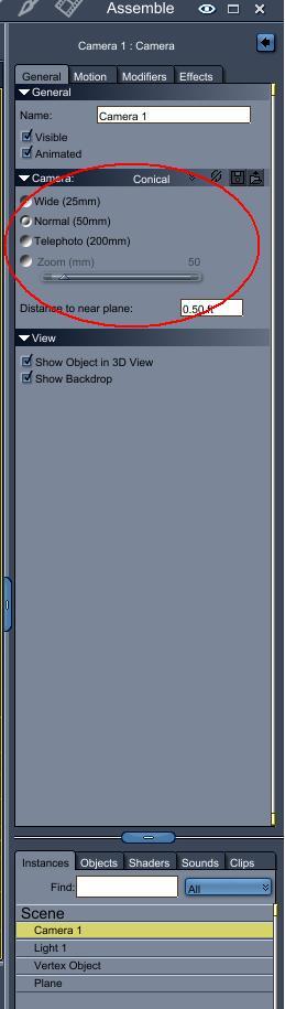

    Something that is very powerful for composition, but which i alway forget to do lol, is playing with the Camera focal length (25mm, 50mm etc).
    yep 80 to 100 (traditional portrait focal length ) does it for me
