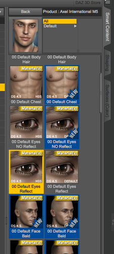

    On a somewhat related note, I see duplicates or doubles in the Content Library and in the Smart Content pane. Sometimes, I'll see two version numbers, different ones, for each of the items. Sometimes, there is a "New" imposed over one of the duplicates. At other times, it seems that both items are the same. Is there anything to do about this? It really doesn't bother me, but I'm wondering if I should try to take care of it in order to make DAZStudio work better.

    I suspect that that is an old .dsf file (from DS 4.0) and a new .duf file (from DS 4.5+) for the same product. Uninstalling won't always clear the old entries, depending on how you installed 9and probably on which database you are suing - I'm pretty sure the old stand-alone installers won't touch PostgreSQL).
  • fixmypcmikefixmypcmike Posts: 19,719
    Actually the stand-alone installers don't touch either CMS -- you get prompted to import new metadata when you start DAZ Studio after installing, but old metadata won't get removed when you uninstall using the stand-alone installers.
    What I'm guessing, however, is that there were both a DS4.5+ and a Legacy version, and both are installed.

    OK, so what if anything could or should I do? If it won't cause problems with DAZ|Studio, then it's all right with me. But is there some way to remove the duplicates?
    Content DB Maintenance > Remove Orphaned Items

    Thank you. I'm just trying to get some clarification or understanding here. Would I have to use this for each item? Each time I clicked on an item to bring it into a scene? Or, would I use it only once?
    When I choose "Remove Orphened Items," would it only prevent the item from showing up in DAZ|Studio, or would it actually remove those items from my hard drive?
    "Remove orphaned items" will only remove the icons for items that are no longer on your hard drive. So uninstall the version you don't need, then use "Remove Orphaned Items" to get rid of the icons. Use the options menu (rectangle with horizontal lines in the upper corner) and it will do it for the whole database, rather than just the items you have selected.
