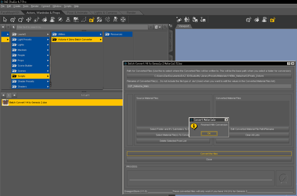

    this did not work for me..I converted VYK Ellie which had 3 subfolders Morphs, Standard, and Poser SSS. when I selected the VYK Ellie folder under files to convert it chose all files including INJ and REM from the morph folder so I deleted those from the list. Now the list just contained only the files from the standard and poser sss folders, so I hit convert files. The program only converted the Poser SSS files and not the files in the standard folder even when I tried deleted all files except the standard pz2's. Is this how it's supposed to work? is it converting the correct files?
  • DraagonStormDraagonStorm Posts: 748
    Kharma said:
    somefunok said:
    I know this is probably a really stupid question but what' the difference between this and the V4 Skins Auto Converter?
    That version let's you load ONE .ds, .dsb or .pz2 file onto Genesis 2 Female. It also does not save the .duf file for you.
    Where this will BATCH convert a lot of files at one time, placing new .duf file formats where you want them for later use. And if you select a whole folder... It will convert all the material presets in that folder and it's subfolders... While maintaining the folder structure to where you want the new .duf files saved to... Takes the tediousness out of converting the files.
    You don't need to delete anything... The script will convert what it is able to convert... Since I don't have VYK Ellie, I don't know what are in those folders.
  • KharmaKharma Posts: 3,214
    I have it all working now, and discovered that I don't have to rename folders as some have mentioned because of memory issues. Just select a folder where you want the files to go, then navigate to a subfolder to convert, or just choose material files a few at a time, and the program will add the subfolders as necessary to save where you want them. This is an awesome program, thanks Draagonstorm!!!

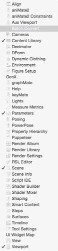

  • Rod Wise DriggoRod Wise Driggo Posts: 2,344
    Not sure whether my problem was already discussed.
    The Converter runs smoothly through the MAT Elite folder (including .ds and .ds.png files).
    But when I try it on Vanessa V4 (the folder contains .dsb and .png files) nothing happens.
    The documentation says that .dsb.png needs to be converted to .png. Well in my case the thumbnails are .png but what do I have to do with the .dsb files which contain the data?
    Thanks for any suggestions!
  • KeryaKerya Posts: 10,943

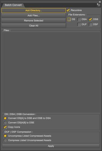

    Quoting from somewhere in this thread:
    The easy solution to anyone with the same problem. Use Studio Batch converter to convert the .dsb to .dsa before run the Batch Converter
    1) In Studio go to Window>Panes (Tabs)>Batch Convert
    2) In the pane select the file or directory which contains any .dsb files, which are encrypted DAZ Script files.
    3) Check Convert DS[A] to DSB and DSB to DSA
    4) Click Apply
    5) All .dsb files will be converted to .dsa

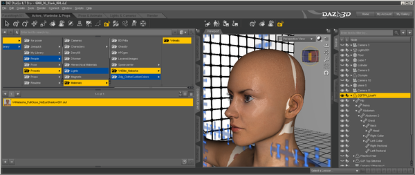

  • Tried to convert a V4 skin but I'm getting ear problems - any idea what is happening? I checked the uv to make sure it is V4 - thanks in advance for any help!
    1920 x 1002 - 131K
  • Wild guess, and only a guess. Tho I suspect you know what your doing looking at the screen-cap.  V4 skins batch thing, uses a V4 UV map for G2F (I know obvious, however), I'm not sure that would work for maps that are not V4 in origin (Like Aiko4 or M4). I don't even know if that would work at all, or if that is anywhere close to what your trying to do.
    May I ask, Whom is the source map from (Figures' name)?
    You and DraagonStorm probably know this stuff much better then me.

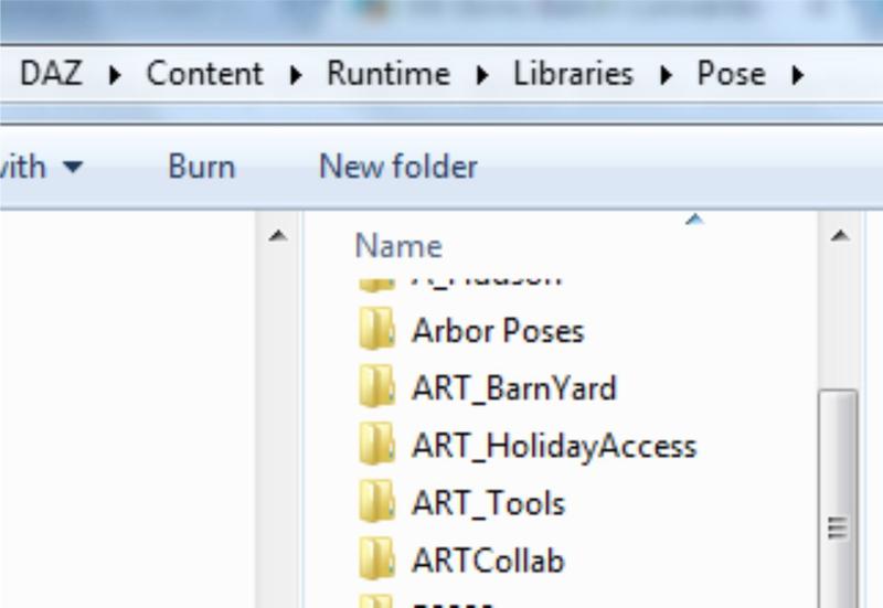

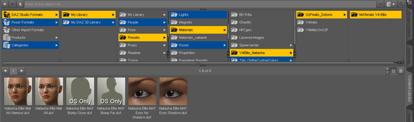

    I've spent WAAAAY too much time trying to figure this out, so going to ask what I'm doing wrong. I've read the six pages of this thread twice and  not seeing this problem. I'm trying Abby by ArtCollab and it's Content>runtie>textures>artcollab and the only thing there are jpgs. I saved as pngs into that same folder. When I go to that directory and folder from the Converter, it looks like it's empty (but I select it anyway, and sure enough, nothing shows up in the converter.)
    But when I approach that directory/folder from my task bar, the folder shows both the file types and the images. I restarted the studio and it made no difference. So what's going on? And can this script do pngs that were saved as from jpgs? But even if that is no, the images/folder contents should at least show up! (And yes, I've opened/closed it several times. No go.) Very puzzled.
  • NovicaNovica Posts: 23,925
    edited January 2016
    And I can't find Abby in Content Library either. I have reloaded her several times using DIM, it shows me where the files are installed (and indeed, they are there, did an uninstall/install again) but I'm not finding her. In Products, only Abby for Genesis shows up. She's not worth this much trouble, but now I am really annoyed.I've checked both the Poser and Daz sections, clicking every thing, and every sub menu. She'd be under Art Collab but I checked Abby too.
    Post edited by Novica on
  • LeanaLeana Posts: 13,502
    Those are the texture files themselves. You need to point the converter to the directory where you have the .pz2 MAT poses files ( Runtime > Libraries > Pose > ART_AbbyGV4 according to the readme).
    You have 2 installers for Abby, one for the Genesis version and one for the V4 version. From what you describe I would say that you have only the Genesis version installed. The V4 version might have been tagged as Poser only in DIM?

  • fixmypcmikefixmypcmike Posts: 19,719
    They should be in Runtime:Libraries:Pose:ART_AbbyGV4
