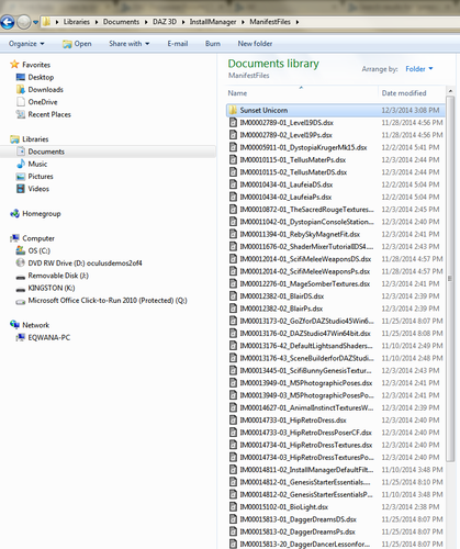

Hello All,
I am attempting to upload some content that i downloaded from Renderosity. However, I am not having any luck. I attempted to put the files in my Install Manager under Manifest Files, but that didn't do anything. Do you have any advice on how I can open these files in Daz? Also my operating system is Windows.
Thanks!

  • cleveret1cleveret1 Posts: 30
    I just followed your instructions. I put it in my Daz 3D Library. However, I didn't get the prompt. Also, the file is a zip file. I opened up the zip, and just copied that folder (I think it had 90+ files in it). Was this done correctly?
    773 x 912 - 102K
    I was afraid of that. I didn't have any luck. I'm not sure what to try next. I might take a break and try again later. Thanks anyway.
  • Design Anvil - Razor42Design Anvil - Razor42 Posts: 1,250
    If you post a pic of the contents of the Sunset Unicorn folder you have pictured it may be possible to tell which level it needs to be placed at in your runtime.
    edited December 2014
    Okay it looks like its all been placed in a wrapper folder for some reason.
    What you should do is move the Sunset Unicorn folder to your desktop.
    Then change the name of the folder from "Sunset Unicorn" to "My Daz 3D Library" (The same as your content libraries main folder as pictured above)
    Then merge the two folders together. (Product ---> Content Library)
    If you look in your content library as pictured above you will see matching folders for Animals and Runtime this is where the content needs to go. I suspect the Promo's folder will just have supporting artwork and is not essential.
