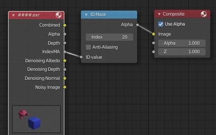

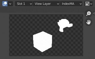

    @Krampus Can you elaborate please ? As I know it there's no way to get multiple layers for the material indexes. I mean, openexr gets one index layer including all the materials. Unless you use the index on a single material so only that one will be in the index layer.
    As for the exporting issues, that's why it's probably "better" to work with the blender compositor.
    336 x 208 - 19K
    Post edited by Padone on May 2021
  • PadonePadone Posts: 4,315
    May 2021 edited May 2021
    @Krampus Unless you mean to first render the openexr then "rerender" the material indexes out of it, for each material. But this you can do with cryptomatte too.
    Then honestly I believe that exporting multiple layers this way doesn't make much sense. It's better to work with the blender compositor directly. Or the target application should be able to handle the openexr layers the same as blender does.
