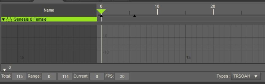

I'm trying to edit a walk cycle by adding some motion to the glutes. I am using the Zev0 glute morphs for G8F but the keyframes do not appear on the timeline when I adjust the parameters. When I select a bone and move it, a keyframe is created at that point on the timeline but not for morph parameters. I've searched the forum but none of the suggestions I have seen (like making sure TRSV is selected, etc.) have made any difference.
Ideally I would like to use Graphmate to fine tune and copy/paste keyframes but Graphmate doesn't see any keyframes for these morphs. Neither does the new DAZ timeline which is just blank for those morph parameters.

    You probably need to enable the right options in the filtering: T = Translation, R = Rotation, S = Scale, O = Other (e.g., morphs and other numeric non-transform properties), A = Alias, H = Hidden. You probably don't have O enabled, or possibly A if you are using something other than the root figure node.
    Sorry but no. I did read that advice in another thread during my search and tried enabling them all - made no difference. Looks like it is not possible to animate morphs.
    I have the Spring Dynamics product which boasts the ability to work with dFormers but with no explanation as to how. I tried but failed to get that to work too.
    Apologies: just tried it again with all of those options enabled on a base G8F and it did work this time. No idea why I couldn't get it to work yesterday.
