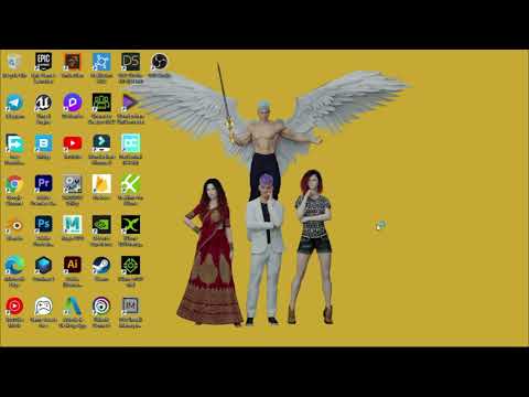

    Found this video, showing the whole process. It is very helpful for a blender newbie like me.
