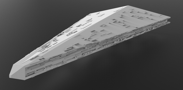

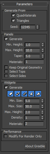

Too bad there is no easy way to do it in Hexagon :(
Wish Hexagon had plugins like this. This took literally less than a minute to make from start to finish. About 21K poly's in total. And the beauty is you almost can't go wrong with virtually any shape.
But it is somewhat easy to make a shape in comfy hexagon, then export it to 3DS max and run some plugins on it, then export it back to hexagon.
1562 x 881 - 1M
485 x 746 - 71K

  • cdordonicdordoni Posts: 584
    I wonder if a displacement map would work.
    The difficulty with an object like in your pic with large planar areas would be getting enough polys for the displacement to work on the flat areas only. Obviously you don't want to smooth the existing hard angles, so you might have to separate the planar surfaces and use the tesellation tools to increase the poly count instead of smoothing.
  • useroperatoruseroperator Posts: 247
    edited November 2014
    well I do know that you can tick off the body when running it through the greeble plugin, and only the greebles remain, you can also select all the top or side faces with one click. So if you were to separate them, you possibly could use the low poly mesh as a base, then have a displacement map for the details in a separate mesh aligned with it. I don't know of any good displacement map generators though, but it would be good for making gaming models.

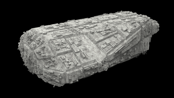

    you can also choose whether to use triangles or quads or both, and that's the only types of faces it responds to...which can help for leaving gaps of detail in a model. for example, the whole backside of this ship, where engines could be, is a simple flat surface made up of more than 4 points, untouched after running it through the process. Now I could say, create a completely different shape to look like engines and seamlessly attach it without any issue.
    triangles aren't as cleanly done as quads though. the real beauty of this is its city backdrop making ability though.
    1866 x 606 - 395K
    Post edited by useroperator on

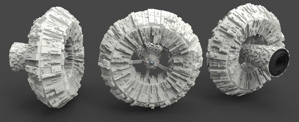

    I don't even know 3ds max that well, although I haven't really tried. but it's pretty simple to import something, run it through a modifier, and export it back out. I have blender too, but I really hate its UI, so I haven't even bothered with that either.
    dun dun da dun dun dun dun da dun. rough around the edged, not bad for 5 minutes work.
    1790 x 734 - 1M
    1206 x 594 - 403K

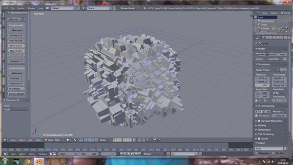

  • RoygeeRoygee Posts: 2,247
    Took me a while to track the new Discombobulate plugin - it really is a world of difference from the previous version - took no more than three clicks at default values to turn a flat plane into this.
    You can either go random, or very controlled.
    Lots of fun - thanks for bringing this up :)
