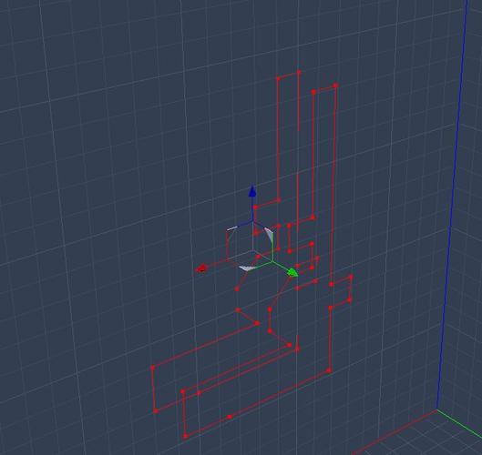

    Usual disclaimer, there is more than 1 way to do most things in Carrara. Without knowing more about your project, here is one way that I might try. If you have pro, use the polyline tool to draw the silhouette of the base item on the front drawing plane in the vertex modeler. Then duplicate and use construct : loft to have a 3d silhouette. Save that to the browser. You now have a base shape to work from that will fit the other shapes. That is, you can fill inside and model the base. You can extrude outward and model an accessory.
    Definitely not the only way. Probably not the best, either.

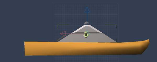

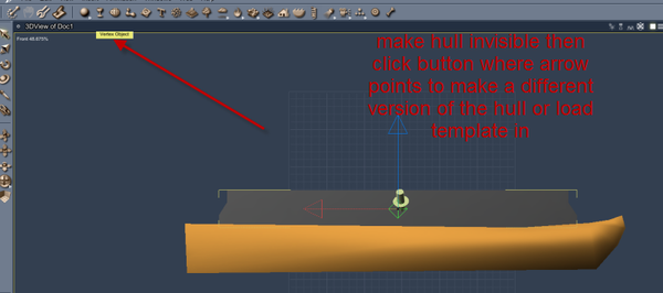

    Yeah - one can model various versions of the boat hulls right over the top of the original or starter hull using the button below to jump into the model room on to the original object. Then - it's a matter of making parts invisible or visible. Naming parts would be the obvious thing to do here so one doesn't end up with Vertex 1 - Vertex 2 - Vertex 3 etc. :)

    I think I follow. So the model would include all the variations of each section, just with all bar one of each section made invisible? And to make a longer boat, it's another pose for the elongated centre section with additional superstructures? That makes for one complex model instead of more but less complex bits that fit together.
    Edit: probably more sensible to have a separate model for each length of boat.
