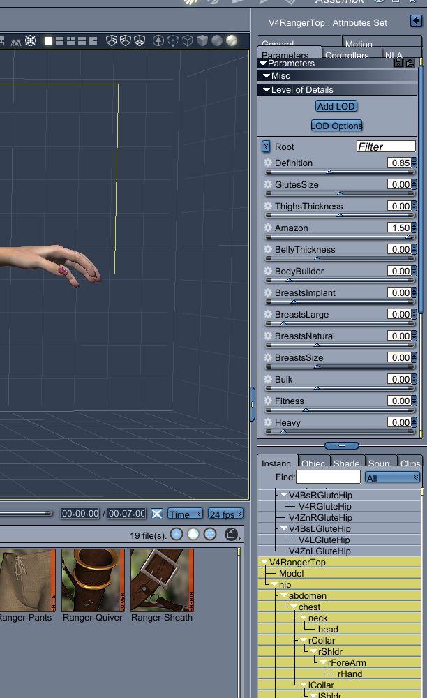

    As Misty said, my first choice to resolve poke-thru would be to explore the morphs that come with the Ranger clothing.
    To see the morphs, select the V4 Ranger Top (for example) in the instances tree on the right.  In the box above the instances, there are 5 tabs - Parameters, Controllers, NLA, General, and Motion.  If you don't see the morphs already, you are probably in the General tab.  Select Parameters. The morphs should now be visible.
    Sometimes the morphs may not work if "V4 ranger Top" is selected.  If you have a breast issue, for example, select "chest."  The morphs there will work.
    My second choice would be to use soft select in the modeling room.  In the instances tree, select "model" under V4 Ranger Top, and then select the wrench icon on the top menu.
    Once you are in the modeling room, you immediately notice that the clothing is in default position, and therefore it is sometimes difficult to find the exact polys to soft select.  To see how the clothing actually looks on the character, while still in the modeling room, look at edit mode in the top right corner.  The left button is selected by default (modeling mode).  Select the middle button instead (animation mode).  The clothing should now look "deformed," as it does on the character.  While you can't soft select or move polys in this mode, you can more precisely select the parts of the clothing that are problematic.  Select a single poly, or shift click and select multiple polys.  Then, return to the left tab and soft select/move the polys from there.  It is relatively quick and effective once you get the hang of it.
