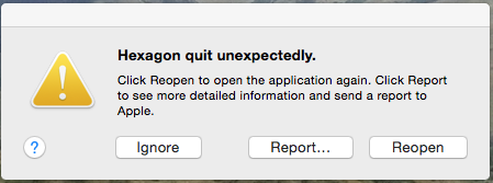

    I tried with Hexagon and it crashed (again). Can anyone suggest another inexpensive modeller. I think Silo is $100 but that is way below the price of ZBrush, etc. Otherwise, I might just have to get used to Blender.
