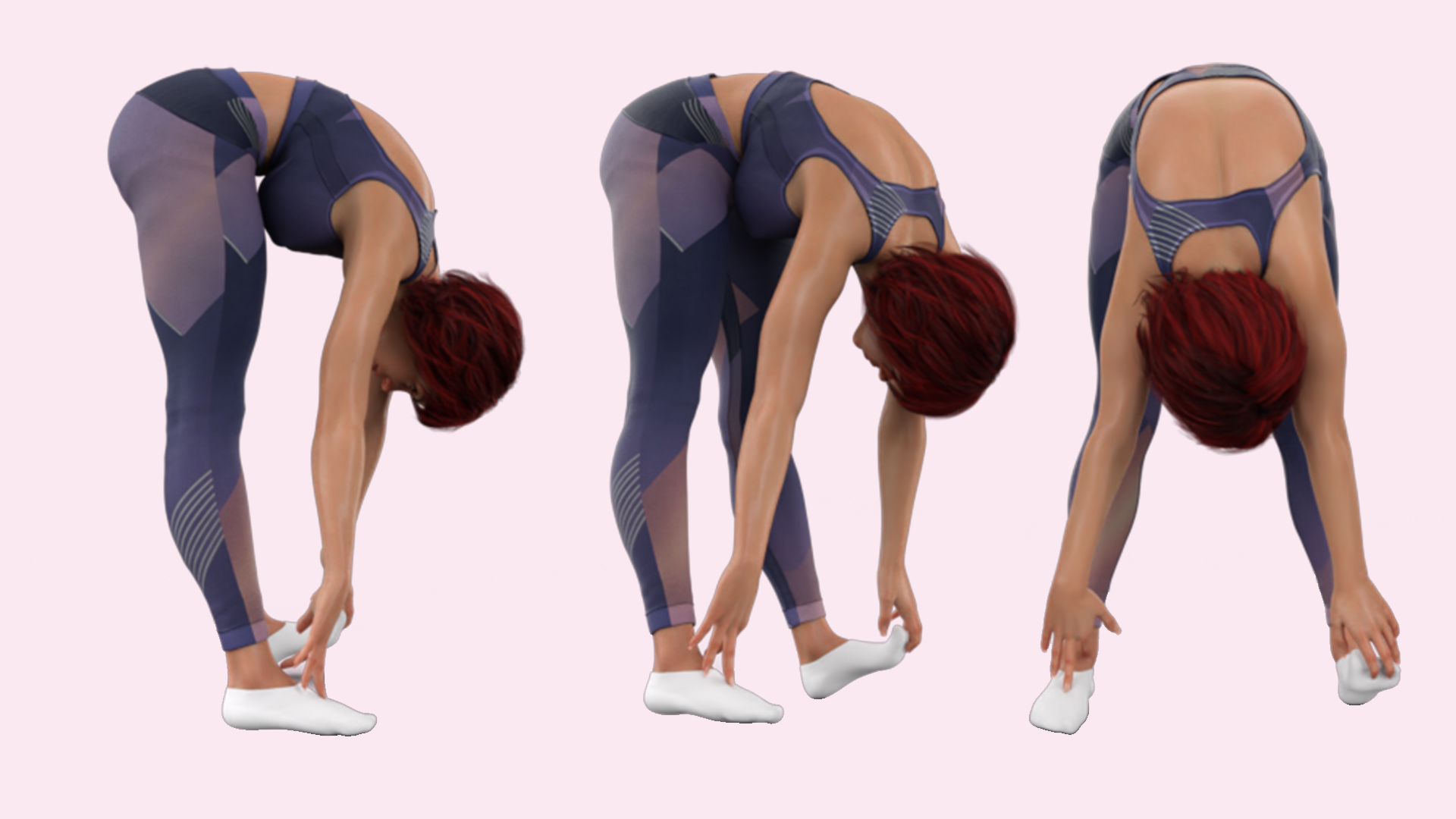

Hi,
is it possible to pose a character in a way that it touches his toes with the fingers. (see example image)
I don't seem able to do it, even with roration limits turned off.
380 x 280 - 12K

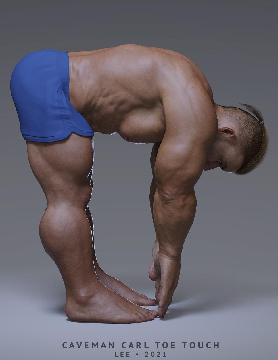

    I was in the middle of working on my beefy G8M character and decided to try making him touch his toes.
    This is what I got.
    Lee
    967 x 1251 - 731K
