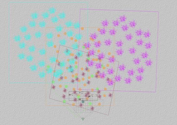

    I use instances quite a lot and haven't seen that error. I have had Bryce crash but that is because I tried to have too much in the scene at the one time :)
    How are you creating the instances and how many at the one time? I generally only do 20-30 at a time and then un-group them, re-group them and then use the instances in the main menu, not the one on the pop up menu, to instance the group and use those groups to use in the scene.
    This image shows a scene with five grouped instances of trees each group is thirty or so instances inside each group.
    The second image is the scene rendered.
    1000 x 556 - 495K
    749 x 529 - 74K
