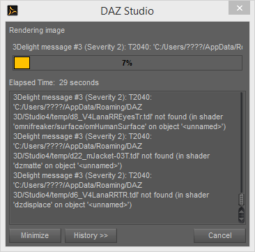

  • borkiaborkia Posts: 8
    Many thanks to all of You, but problem seemed to lay more deeply, then I hoped.
    The problem is that 3delight can not detect installed lights and shaders - i`ve installed default lights and shaders right after installing Daz Sudio.
    An, oh, i`ve tried different render settings with the same result.
    Think it is time for tech support :(
    366 x 361 - 17K
  • prixatprixat Posts: 1,630
    Do those question marks in the filepath mean your username contains non-english characters?
    In DAZ preferences change the temp location to something simple like G:/DAZTEMP
