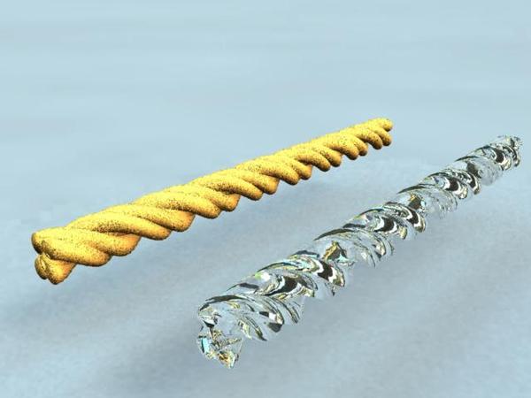

  • Design AcrobatDesign Acrobat Posts: 459
    edited October 2014
    I have Carrara 8.5 pro and I am looking to create a crystal helix very similar to a braided rope. I saw on one thread ( I can't find it now } a formula to create a helix. I tried it and it didn't work. It did nothing at all. Does anyone else know of a way to do this? Thank You in advance.
    Read the other posts, not sure about a formula either.
    This is a quickie so not quality.
    To make a rope - make five cylinders or more in modeler and have them intersect each other.
    Cylinder width = 3, cylinder height = 50 cylinder segments (sections) cylinder sides 32
    weld these all together
    In the assembly room, use the twist modifier and use 1440 as your input (4 full 360 degree twists) to make a standard rope
    Now for a helix, I just used two cylinders with the same dimensions. could use more not connected. Same as before weld before going into assembly. I would make the other stuff on the inside separate.
    Apologies for the quick explanation , have to run to an appointment, shower eat and all that before ....
    640 x 480 - 22K
    640 x 480 - 27K
    242 x 289 - 23K
    Post edited by Design Acrobat on
