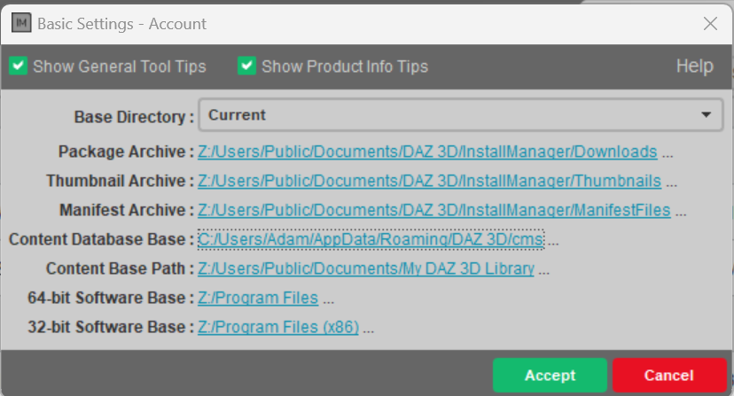

    And neither DAZ studio OR Install manager will let me change the drive. They both revert back to the C drive when I try (neither are open at the same time and I don't have daz central installed yet)
  • edited March 2023
    As you can see, everything else is correctly set to the Z drive... but THAT file pathway will NOT be updated. It keeps on reverting to the C drive no matter how many times I change it.

  • SofaCitizenSofaCitizen Posts: 2,185
    edited March 2023
    Does that location on drive C exist? If so have you deleted it when all the applications are closed and then see if it gets recreated on launch of one of them?
    Is there a valid CMS folder on drive Z where you try and set it to - i.e. the folder you try and point it to contains a folder named "ContentCluster" and has valid PostreSQL files inside?
    EDIT: It seems that the postresql.conf file is stored inside the ContentCluster and so that should mean that the CMS application itself does not have any inherent config which would enforce a path and so it should be fed it's path by either the value stored in DazStudio or by DIM.

    Yes... there ABSOLUTELY IS a valid CMS folder on the Z drive, as you can see per the screen shot.

  • Richard HaseltineRichard Haseltine Posts: 111,890
    Have you tried a different folder on the Z: drive? My suspicion would be that there are permission issues, or possibly database corruption of some kind.

  • AgitatedRiotAgitatedRiot Posts: 4,768
    Have you tried just to set the folder location in DIM?
    edited March 2023
    In the Image file, his uploaded image points to C:/USERS/ADAM/APPDATA/ROAMING/ DAZ3D/CMS.
     It should point to the Z:/Users/User/AppData/Roaming/daz3d/cms
    or whatever path is desired, the folder names along the way are not functionally siginificant (although I think they may need to limit themselves to "standard" characters).
