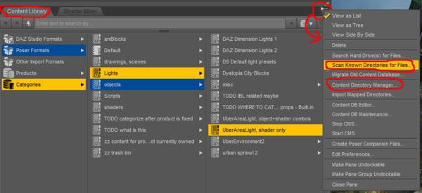

  • srieschsriesch Posts: 4,243
    In the above-described window, note that there are multiple kinds of content. You probably have either DAZ Studio or Poser content, or both. If you use both, you will need to add your content folder twice, once for each of the two types. Note when you map your folder here, you want to map the folder that CONTAINS the Runtime folder, not the actual Runtime folder itself. Same thing for DS content. After you have have created these mappings (or verified they are correct), you also need to go back to the Content Library's menu and select the "Scan known directories for files" option to search these folders for mapped content.

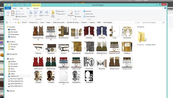

  • MegarigMegarig Posts: 88
    edited October 2014
    When you install content, note that different products are packaged differently, and sometimes you will have to move files or folders around so the top level of folders is where you want it, and also if you manually unzip it is very easy to unzip into the wrong folder.
    If you think everything is correct but you still can't find it, post a screenshot showing both your mapped content folder(s) and the actual Runtime folder with path in Windows so we can compare; maybe we'll see something you overlooked.
    Also note that if you try to install a product that you already have installed, it won't show up in unassigned because of course you already have it categorized somewhere. That's probably not happening, but I suppose it's possible.
    I use only DS content. I'm not entirely sure what you mean by "mapping" content. Can you clarify that for me? Anyway, I extracted from my zip program to the directory that is flagged in the screenshot. And as you can see, I am not seeing any of the content. What did I do wrong?

  • Richard HaseltineRichard Haseltine Posts: 112,275
    The items in My DAZ 3D Library\Content should just be in My DAZ 3d Library, the Content folder is stopping things from working. The items will then be in Poser Formats>My DAZ 3d Library>Some library folder (though I thought Norse Village had native DAZ Studio files).

    By "mapping", I mean: In the Content Library pane's menu, select Content Directory Manager, click on "DAZ Studio Formats" (click the '+' button to expand the list and then post a screenshot of this for us), then with "DAZ Studio Formats" selected, press the Add button and browse to and select the appropriate pathname (described earlier) where your content files exist on disk if not already done. (I should probably stop using this term, I don't even recall why I started using it.)

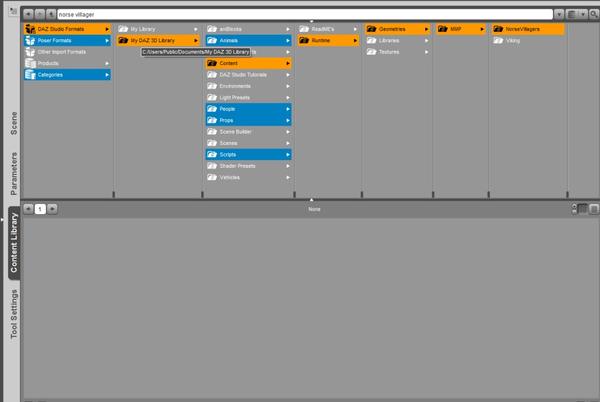

    edited October 2014
    I probably screwed this up, but I copy/pasted (from the downloaded content folder) all the subfolders of the textures, geometries and libraries folders into the appropriate directories - but I still get nothing. For instance, in that first shot, isn't that one of the proper directories?

    In your Content Directory Manager screenshot, assuming that's where you wanted to install them (looks like the defaults?) that does look correct to match the Runtime folder seen in your Windows screenshot.
    If you moved files around to fix this, did you actually tell DS to search for your content again after the fix? ( Content Library’s menu and select the “Scan known directories for files” )
    I'm not sure where the Content folder was that Richard mentioned relative to your files were, and I'm not sure if when you said you wanted to copy the individual content folders, if you actually meant folders with "Content" in the name or not. Currently, is there a folder actually called "Content" anywhere, or has that been eliminated to fix the issue?

    I've had DS scan known directories a couple times, to no avail. But I may had had it all wrong in the first place. I think in the Readme that came with the download, it said I should put the entire content folder into the main DS directory, but I think that may be wrong. There currently is no "Content" folder for this particular content, and I am - when I get time - going to just add the individual content folders found under textures, libraries and geometries into the corresponding folders in the main Runtime directory and see if that fixes the problem.
