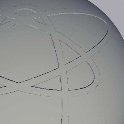

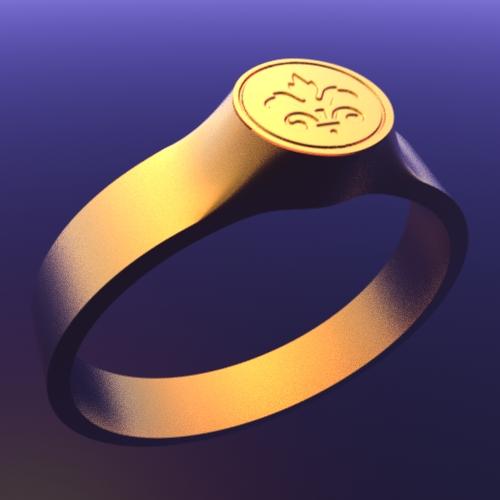

What's going on at once with the displacement ? I use a part from a very high poligon sphere. The edges look hideous.
I tried everything, a bigger blured picture with map and the size 2048 X 2048, higher poligons, less displacement. I'm at a loss. Can anyone help me please ?
On the ring the edges are round and sharp.

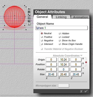

    It may be that you will need to adjust the micro polygon size. It can be found at the bottom of the attributes menu. It is greyed out for me because the material does not have displacement set. If I set it I would have crashed Bryce. Unless I set the priority to low. But here you should be able to enter in a smaller value and that may help, potentially. This is not something I've experimented with much due to the instability of the feature and my aversion to unstable features.
    Thank you very much David, now it looks better. I set the Micropolygon to 0,1.
    Two questions:
    How much polygons must a model min. have for displacement ?
    What is the ratio of the micro polygon value to the real polygon count of the models ?
    My Sphere from Blender have 1015808 polygons. I think that more polygons make the edges looks better. Or is that wrong?

    I'm no expert on displacement, but as far as I know, there is no dependency on the models geometry. The micro polygon displacement is a material effect. And the only material effect that is dependent on models geometry is curvature because it uses the surface values to drive the filters. Displacement on the other hand is like bump effect and instead relies on the image maps that drive it and the micro polygon level to determine the size of the simulated geometry.

    It looks as if the main problem is the bitmap which I use. The corners are not sharp but jagged. This is a problem from the sotware i use. I have test different programms, but the problem is always the same and the edges blured leads to no result.
    I'll go now another way to get a decent bitmap. I model the bitmap with Hexagon or Blender and make a 2D picture.

    And here is the test render, now I am satisfied.
