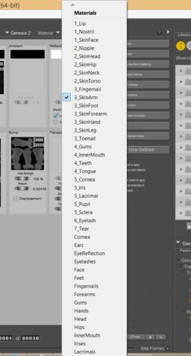

I'm trying to solve some issues with Reality for Poser, when working with Genesis2 figures. When the figure is added to the Poser scene Reality collects the data about the materials. This is done via the usual scanning of the actors in Poser.
What is unusual is that the list of materials reported is doubled. There is a set that uses the old Gen4/Genesis convetion, like 1_SkinFace and then another set like "Face," "Torso" and so on.
Unfortunately we cannot attach images here otherwise I would give you an example.
Anyway, these two sets of materials are found attached the the same figure. Can you tell me what's happening and what would be the remedy for this?

Regarding the extra materials, we suspect that this is a side effect of selection sets. We will review this.
Regarding the SubD actor. Yes the figure created by DSON includes a SubD actor. This was how it was implemented before Poser had subdivision surface. We currently need it for edge weighting and HD morphs among other things..

It would be very helpful if there was a way of detecting the false materials from the real ones. I refer to the "1_SkinFace" and so on in Genesis 2. Is there a property that can act as a flag?
