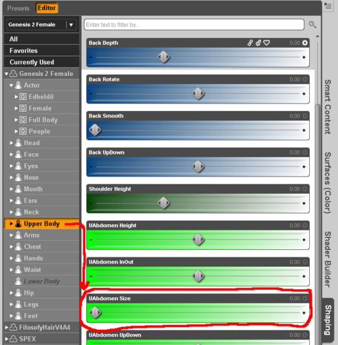

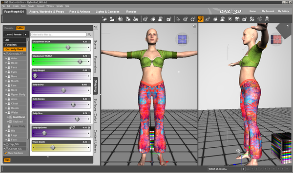

    G2F Barby-waist syndrome, easy fix, lol.
    Shaping -> "Upper Body" -> "UAbdomen Size" (light green slider).
    I don't remember what morph set that came from.

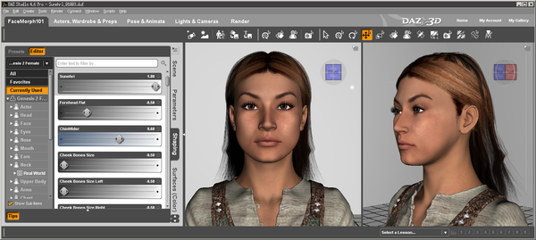

    Took another spin in the "Multi-Axis Trainer". Smaller eyes, Different ears, Not happy with the nose still, lol.
    "O" and that shirt is from the "Ranger Outfit", random selection. "Wilmap" has allot of stuff that is not skimp-wear, lol.
