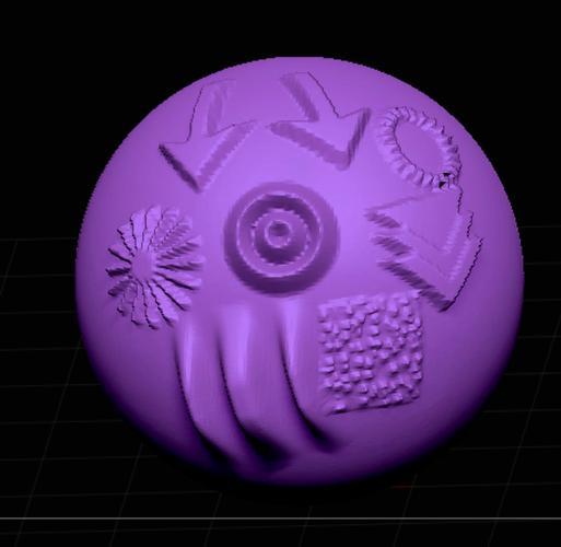

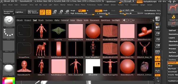

    Do you happen to know where the Cone3D,  Arrow3D, Ring3D, SweepProfile3D and all those are located?
  • PendraiaPendraia Posts: 3,626
    Give me a moment and I'll have a look.
    If you load Zbrush and then click on the yellow S icon which is part of the tool menu you should find them there.
  • NovicaNovica Posts: 23,925
    You found it in a heartbeat and I'm opening all those darned flyouts.... Thank you so much!  I'll add that to the reference links at the front under Parametric.

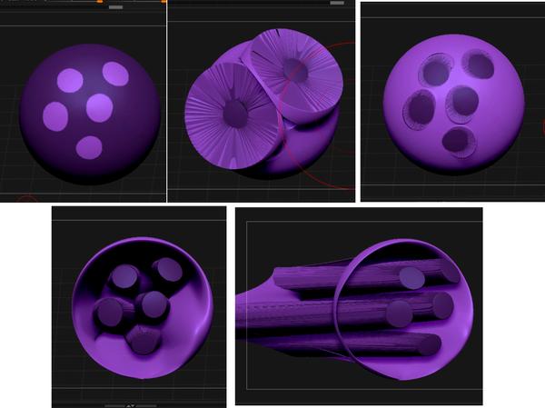

    Now, here's where I am stuck. Been redoing this over and over for three hours, from scratch, and it's not working. At exactly 3:50 in the video, I have cleared the masks so nothing is masked, when I Crtl+Shift on one arm (the one on my right) it indeed shows up and the rest is gone.
    Next, I Subtool>Split>Split Hidden. I have tried this, btw, with and without still holding down Ctrl+Shift, because unlike the video, when I click the Split Hidden the body DOES NOT COME BACK. It shows the arm as a subtool separate from the body/rest of the figure, but clicking out in the viewport, dragging out in the viewport, holding CTRL+Shift and click, or CTRL +Shift drag in viewport OR on the arm, OR where the body would be- doesn't bring the darned body back.

    Aha. After FOURTEEN HOURS of putzing with this I solved it. It involves masking half, hiding it, split the hidden (so it keeps both halves), duplicating, mirroring and merging. So thanks anyway Pendraia!

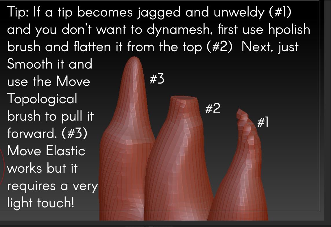

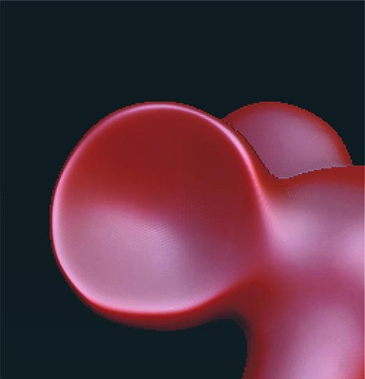

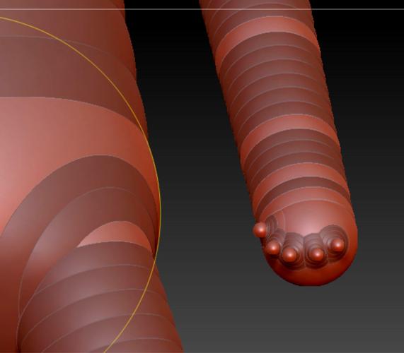

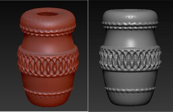

    I'm going to preference this by reminding everyone I am putzing around, what I offer as tips is not necessarily (and probably NOT) the ultra best way to do something, but it's a quick fix or what (SEEMS) to be working.
    When you dynamesh, it fixes the mesh, making it more uniform (correct me if I'm wrong of course) but I haven't found a way to target areas with that. Is there a way to mask and only dynamesh one area? Dynameshing everything can be a problem as it smooths out lines and things you don't want smoothed. So I wanted to fix some claws that got severely messed up and this is an easy way to do it, with very nice results. From here, if you want sharp points on the end, use Snakehook brush.
    Edit: the backside on #1 was really distorted, the front was going to a nice point.
    1145 x 785 - 381K
    Post edited by Novica on
