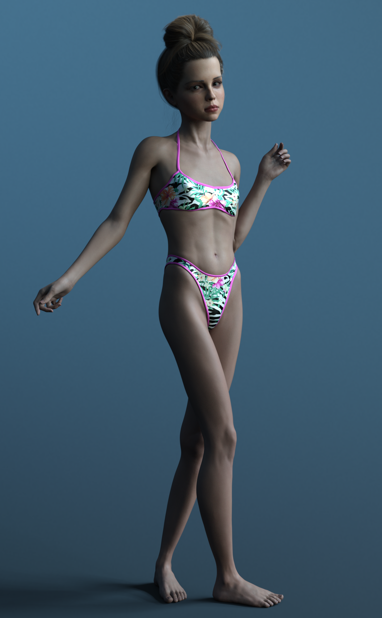

    Ah, yes. Mystery solved. Thanks, again! That explains the outcome. In any case, I am happy with my result.
    1236 x 2000 - 2M
    Post edited by thd777 on
