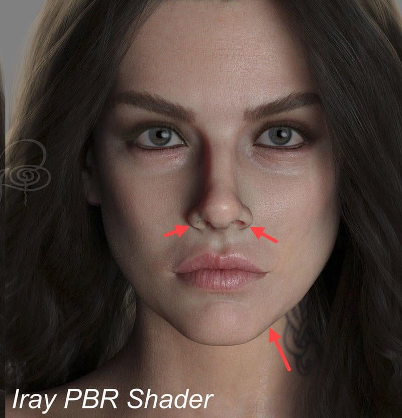

    What settings do I adjust to get more light to passthrough, especially the nose and ears in PBRSkin? The settings Melissa posted is a godsend but it kind of looking, for lack of better understanding dry/flat? on my character, espeically in face closeup in nose and ears.
    I would still take dryness to waxiness though, but maybe it's just because I didn't know what I am doing whether in Uber or PBR.

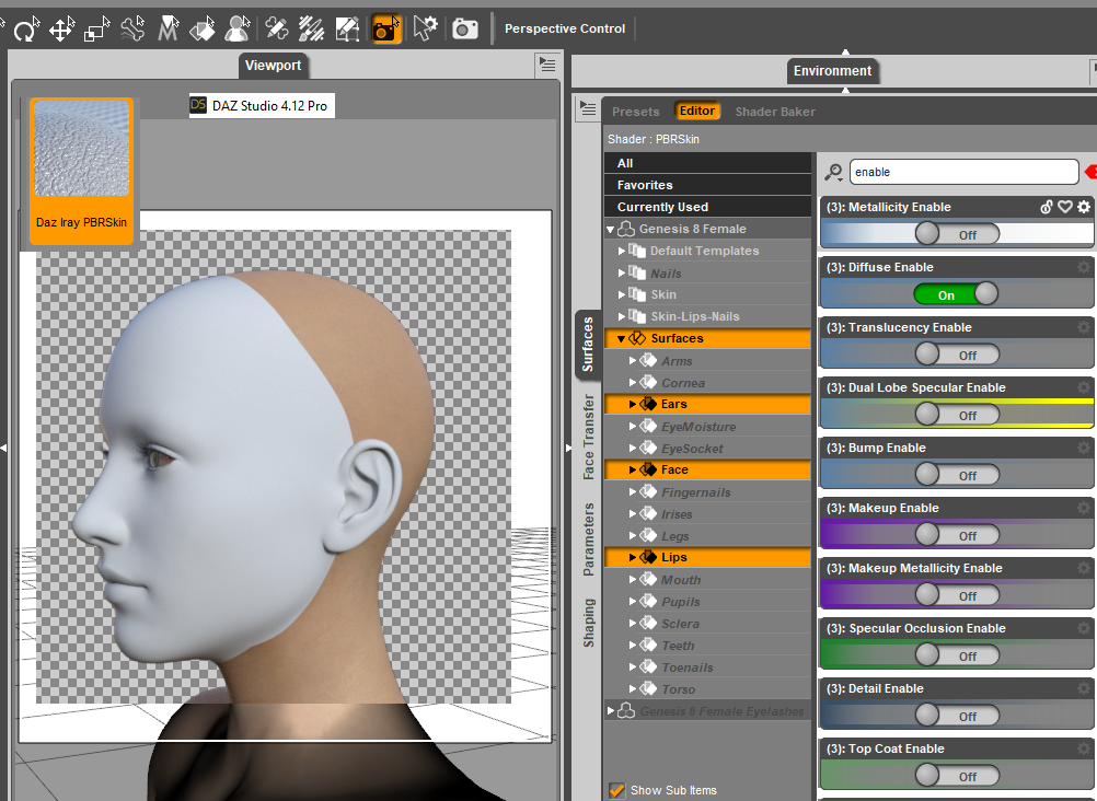

    aldoraeno said:

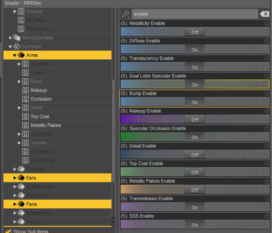

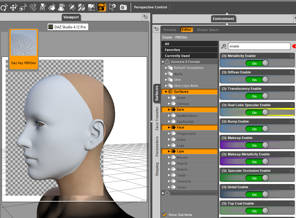

    It took me a while to figure out what I was missing here, so hopefully this will help other people avoid some of the same confusion.
    Prerequisites
    • The latest Daz Studio 4.15
    • The latest package update for Genesis 8 Male/Female Starter Essentials
    Applying to a Genesis 8 character
    1. Load your Genesis 8 character.  It doesn't have to be on an 8.1 figure base, a regular Genesis 8 is fine.
    2. In the Surfaces pane, select the surfaces you want the shader for, most likely your character's Skin and Lips.
    3. In the Smart Content or Content Library pane, find and load the "Daz Iray PBRSkin" shader.  (Your character probably now looks like a pale white ghost in Iray.)
    4. Type "Enable" into the search box a the top of the Surfaces pane.  You'll see a long list of On/Off buttons, with only Diffuse Enable turned on.
    5. Turn on Translucency Enable. (You should now have a darker but transparent-looking ghost character in Iray.)
    6. At the bottom of the list, turn on Transmission Enable and SSS Enable (these buttons didn't exist before step 5). This should make your character finally appear corporeal.
    7. Turn on any other shader features your original skin material used:
      • Most Iray skin uses Bump and Dual Lobe Specular.
      • Some unusual skin materials or makeup may use Top Coat, Metallic Flakes, and/or Metallicity.
    At this point, your character when rendered in Iray should have skin fairly similar to what you had before applying the PBR Skin shader.  Hopefully it looks better in some ways. It might be shinier, lighter, darker, etc.  Clear the search box and tweak any settings to adjust for whatever you're looking for.
    Note: If your character is way too shiny after turning on Dual Lobe Specular Enable, you may want to also turn on Specular Occlusion Enable and greatly reduce the Grazing and/or Facing values under it to get a more subtle sheen.  An occlusion mask texture is not required for this.
    if you have to do all that to make the skin look like it did prior to applying PBR, why bother?

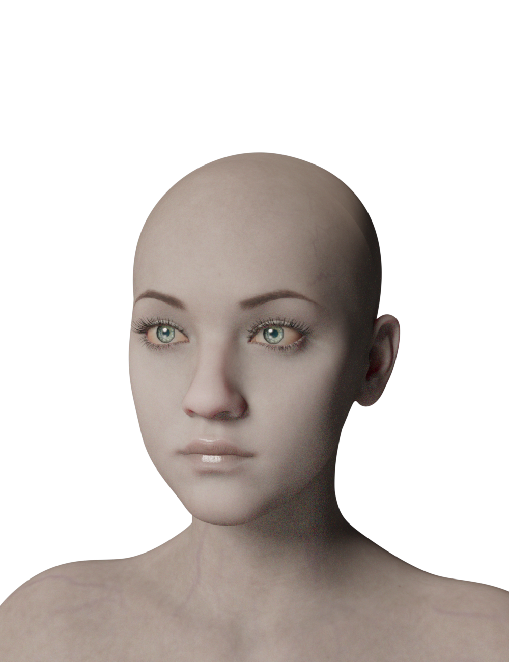

    Yeah, spectral rendering can make a really big difference.  Here is the texture from VOOTW's Vo Rose (which has mysteriously disappeared from the store) on Jessai's Verity.  Translucency turned down a smidge from 0.9 to 0.8,  Added a bit of freckles and Those Things Horizon Vellus. Straight renders; no post.  Results will vary a lot depending on the texture settings.
    On
    Off
    1108 x 1440 - 1M
    1108 x 1440 - 1M
    Post edited by Sevrin on
    edited April 2021
    On
    Off
    In your example, I honestly prefer 'off' as the 'on' image seems to have a greenish cast, which is a common issue with spectral rendering. Here is a comparison that I worked up for the article I'm writing...so it's my Uber Shader settings for standard compared to my Uber Shader settings for spectral rendering. The goal was to ensure that the level of sss I had with standard rendering carried through to spectral rendering, and for her skin to not go green. It turned out a smidge on the pink side, so I might revise the settings a bit before I hand over the finished article -

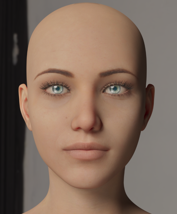

    Here is a side-by-side comparison of a franken-skin I put together (mostly Babina 8)(I only updated the head, so please ignore any funk in the neck on the right) -
    And here is the HDRI I used in case anybody wants to replicate the lighting - https://hdrihaven.com/hdri/?h=studio_small_03
    Do you have any of the SSS channels enabled? This is very lovely
    Yes, both are using a translucency value of .9. SSS settings are somewhat tweaked but similar to what you would see on a base G8 figure, which is also the same as V8.1 I build out custom sss maps that have actual "meat"...which is the big factor in the look. Just using a lightened copy of the diffuse map doesn't do it...not sure why Daz hasn't caught on to that yet. Skin is translucent, so you should be able to see what's under it.

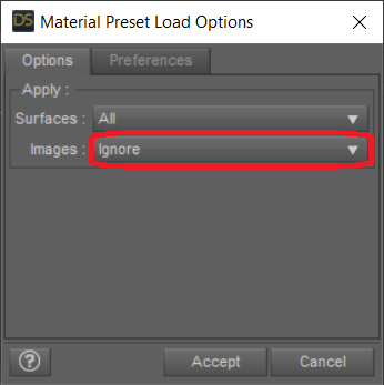

    There is a much simpler way to convert the Iray skin shader to PBR:
    1) Apply your Iray skin shader to your character as usual.
    2) Go to a character with PBR skin (such as Vicktoria 8.1 or Michael 8.1)
    3) Hold CTRL +ALT and double click on that character's skin.
    4) A pop-up window appears, choose "Images > Ignore". This basically means that you are loading the shader without the texture maps!
    5) Since characters with PBR are typically 8.1 characters, applying their skin shader will change the UVs to 8.1. If your chosen textures are 8.0, you need to switch it back to 8.0
    This is done in the Surfaces Pane, search for UV and choose "Base Female" or "Base Male".
    All done!
    NOTE: Your character might now have a different look due to the different properties of the PBR skin shader you are using.

  • TugpsxTugpsx Posts: 921
    edited September 2021
    Both formulas provided decent results. Thanks for sharing.
    All done!
    HERE are my PBR skin settings:
    Top Coat Roughness: 0.55 body ; 0.45 head ; 0.40 face ; 0.3 lips [The face tends to be more oily, the lips even more, the head is changed for a smoother transition]. If you want a more "shiny" look, you can reduce these by 0.1 each [body to 0.45, face 0.35, head 0.4, lips 0.2]
    I don't usually respond here very often because I am just a beginner at DAZ, but this little tip helped me find something that I think is not supposed to work but does. I wanted an asnwer to using PBRSkin shader on Anatomical Elements, everything says it can't be done, but using this method forces PBRSkin Shader on genitalia. Since I was using a G8 texture I did have to apply the Base Female UV after copying the Victoria 8.1 shader. Not only were all the standard skin textures converted to the new shader but the Anatomical Elements were converted at the same time.
    You can't simply double-click on PBRSkin Shader with Genitalia selected in the scene, it simply ignores the script and remains Iray Uber. I am still not sure if this is the correct way to accomplish this and I haven't tried it with other genitalia. Maybe it will but I don't want to mess around too much with this. At least now I have a starting point to play around with converting my G8 models to G8.1 models with new skin shaders. Thanks for figuring this out.

  • cgidesigncgidesign Posts: 442
    edited February 2022
    What is causing those strange shadows around the nose and chin? It looks somehow wrong to me (a bit like ambient occlusion is added into the lighting mix). But beside of that the skin look great.
