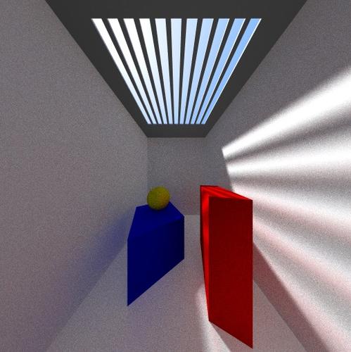

Hi there,
Still playing with TA. Today I've set up kind of an interior scene: A box hollowed out by another box with some long openings in the top of the box. In the inside some basic primitives. The scene is lit just by the sun, TA, and a Cube Fill Light in the size of the inner box that forms the room. Already quite a believable indirect illumination in my opinion. I like it, except for one thing: The ceiling doesn't seem to be as lighted as well. It looks like it's not TA-rendered at all. Very strange, and I just can't figure out where my mistake is. If you want to play with it go ahead, I've put the scene file here. Any help is welcomed.

    As far as I know, it's a bug.
    Easy fix: Select everything and group and then in attributes put it 0.1 rotation on Z or X axis.
  • ueanyueany Posts: 0
    Man, that was fast. Thanks a lot, it helped!
    (Nice to know it was not my fault because it's just a bug)

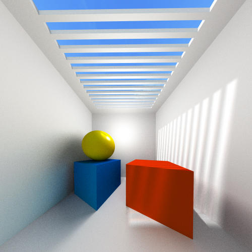

    My second attempt of a better interior lighting. Set everything to max quality in Bryce the render times was horrendous (~ 20 h), though still fun to see what's possible with that aging program. :)
    512 x 512 - 47K
  • HoroHoro Posts: 11,780
    @ueany - beautiful! Was worth waiting. 20 hours horrendous? I'm glad when I get a result in a night, if it is going to take more than 5 days, I start pondering whether it's worth the trouble. Quality needs time, that's also so with other 3D programs (it's amazing what kind of shortcuts even professionals take to bring render time down). On one thing all 3D users agree, no matter what software they use: a render always takes too long. ;-)

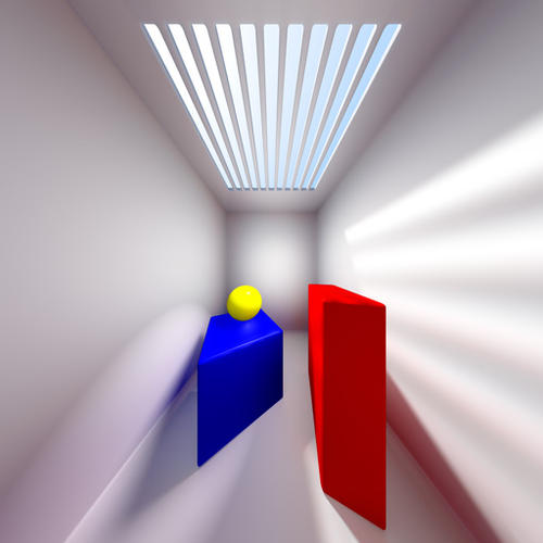

    I think I may also be of more help with your render time too. I hope you don't think I'm cheeky, but I recreated your scene using the same elements if not the exact same layout.
    With a few tweaks and compromises to optimise render time, mine rendered in just over a tad over half an hour.
    I use an 8 year old laptop for Bryce so I'm not on a fancy fast computer.
    The main changes I made in my set up were to remove the side of the box behind the camera which allows light to flood in thereby doing away with the need for using one of the render expensive dome/fill lights and replacing it with a single radial light.
    The rest of the scene is lit by the Bryce sun and IBL from one of Horo's HRDIs.
    The other thing I did was to reduce the quality to 144RPP. In a lot of cases, there will be no discernible difference and you'll be halving your render time and where render noise isn't so much an issue (when bump disguises it), 36RPP is enough.
    I can post screen grabs of all my relevant settings if you'd like to see them. I'm not suggesting that mine is better or even the same as yours, but that with some minor alterations to your set up, you can vastly improve your render time.

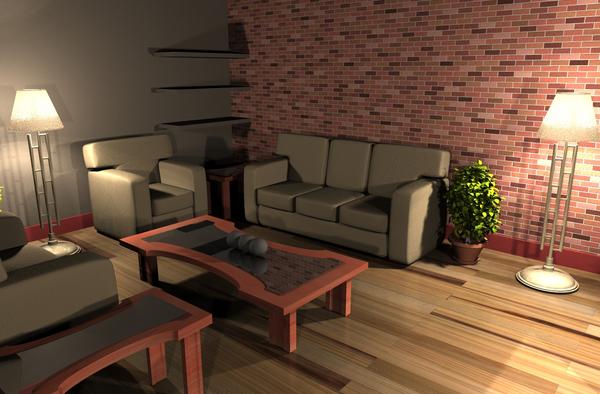

    Now for some results.
    Below I have a few renders for you to consider. This is an Interior Lighting study I undertook long ago, but I revised it the other day for this thread.
    No indirect light at all: First we have a simple six sided room, fully enclosed except for a small window that is out of view. There are four lamps in the room, one for each vertical wall. Again, two of them are out of view. I did this on purpose, as the lack of indirect lighting is most obvious in renders where there aren't direct lights shining in from multiple directions. Notice the deep shadows in many areas. It's still not bad for a Bryce render. But where is the indirect?

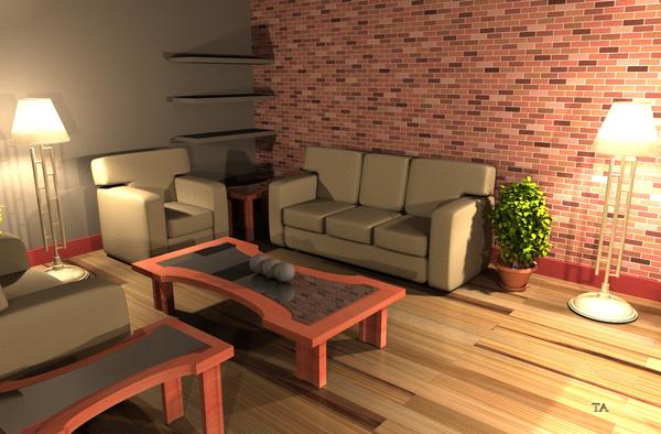

    That said, this second shot is the Premium Rendering method. All of the effects have been set up for rendering in this particular mode.
    This scene is my take on a well tempered True Ambience. Boost Light / Scattering Correction / Reflection Correction / Soft shadows are all engaged. The lamps are radials with soft shadows assigned. You will notice there is very little noise because I have enough point lights arranged around the room to bake it away even at low quality setting. This is only rpp36, and max ray depth 4. This was pretty fast for a TA render and quite noiseless for a Boost Light render. As Savage states, TA renders can be fast. However it is important to note if color bleeding is important to you that at really low Max Ray depth settings like 1, 2, or 3, the indirect light bounces carry almost no color information while bouncing, you're getting mostly a grayscale ambient occlusion effect. Not every TA render is a TA render in that regard.
    The third render is my Standard AA example. Here, twin 3D Fills are employed (they need to be twinned because there is a slight directional bias with 3d fills because they are off centered a bit, and to correct it you need a second one rotated by 180 degrees). The quality from the 3d Fills is very low, around 50 virtual lights each. The key light from the lamps is coming from small domes. Domes when used as key lights automatically provide soft shadows, based on their size, so never engage soft shadows within the light lab when working with Domes or 3D Fills. The drawback with Domes and Fills is the same as with IBL and that is the point-like nature of the lights leads to shadow banding at low quality settings. I've used just enough quality here to hide the banding in most places.
    Now the first thing you are probably thinking is that these last two renders appear almost identical. And they do. That just goes to show how powerful and underestimated the 3D Fill light is. And to boot, the result was completed several hours faster than the TA version. Interiors are what the 3D Fill was designed to do.

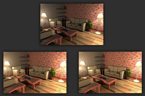

    Upon closer inspection however, the TA render has the advantage. Looking at the legs of the tables and the sofa near the plant you can see a definite difference. But this is only if you look closely for the differences, at first casual glance the 3D Fill render is not hindered by the lack of color bleeding.
    For easier comparison, I have included a sample of all three renders side by side.
    So if I were you I'd pick one direction and go for that. If color bleeding is what matters most to you, then TA is the ONLY option. But you will be limited to the control TA gives you as the end user which isn't very much when compared to the flexibility and speed saving from using 3D Fills and Light Domes.
    Neither of these renders was exhaustive, I could up the quality on both of them if needed. These are just good enough to get by type samples for your enjoyment.
