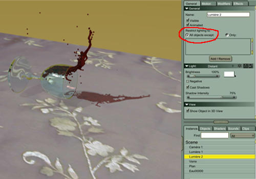

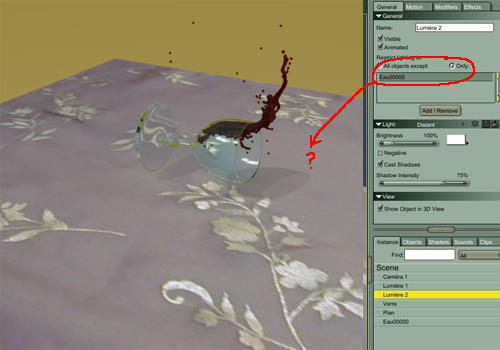

    Hello Eric,
    The problem in connection with the shadow is difficult to explain, I will try with my limited English.
    In this render published on Youtube, we can see the shadow of the object (the liquid), but the color is very intense.
    To avoid that, I added a light for the liquid only and prevented the first one to light it.
    I realize whereas there is no more shadow at all !
    I will test on other seq objects to see if there is the same thing.
    With regard to the interaction with the bullet objects of the scene, there is always a workaround, not problem but I wanted to know if it were normal.
    Thank you.

    I don't have the plugin, but my understanding is that the animated object is a different object for each frame. I suspect that light linking will work only on the object in the first frame, and then because the subsequent frames use a different object per frame the link is broken.
    Is that accurate Eric?
  • DUDUDUDU Posts: 1,945
    You are right EP, it's only the first object which appears in the lists of the scene but then, why is there a shadow when it doesn't have exclusiveness in the light ?
    It is rare that we uses only one light in a scene, it's for that it's awkward.
    It's not really a different object (I probably should have used a different word), but the mesh is completely swapped out. I would expect lighting to work like it does with anything else.
    What I was trying to convey is that if you animated a sphere in Carrara natively, you'd have this object that changes its position from frame to frame. Carrara can calculate its velocity, how hard it hit things, etc. The local coordinates of vertices don't move, but the global position of the whole object does.
    With a sequenced OBJ animation of the same sphere, the movement is baked into the mesh. The global position of the object doesn't change, but each frame gets a whole new set of vertices and facets with different local coordinates than the previous frame. Carrara doesn't know what to do with that from a physics perspective.
    Post edited by Eric Winemiller on
  • Eric WinemillerEric Winemiller Posts: 84
    I think I see what is going on here. What you've said is illuminate only the spilled wine. Since the table cloth is not being illuminated, it gets no shadow. You have the same effect by dropping a sphere primitive into the scene and making it the only thing illuminated. It will not cast a shadow on the table from that light.
    Regards,

    In connection with the shadow, it's easy to duplicate the plan and to apply a shadow cather “texture" to it.
    I didn't know that it was an issue of Carrara, I remember now that I already had this problem and I thought that my scene was corrupted.
