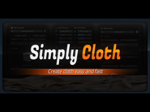

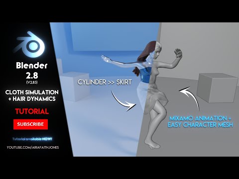

    Md is now subscription only. But have a look here:
    and here
    The first addon uses initially bezier curves instead of meshes, that's the trick. You can transform the cloth into a quad mesh later on, and depending your base model use this geometry directly with your model in blender or bind it to any rig if needed.

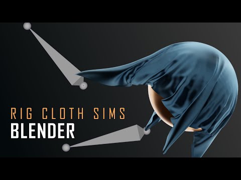

    Another trick is to rig the garment to the character, nothing fancy... with defaults weights, and then only sim the parts of the garment which must move in order to be convincing.
