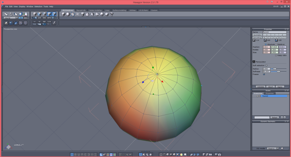

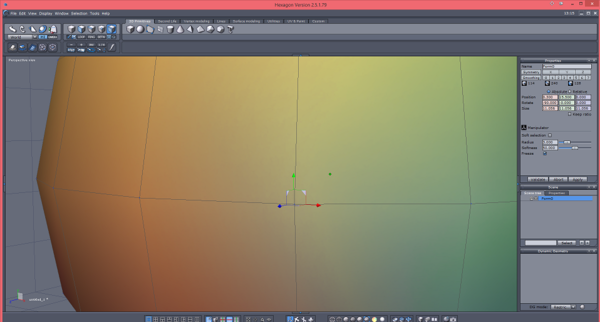

Nope, it's not applying it to ANY vert, that's the odd thing. It's dropping it inside the geometry. Here are two screenshots. The first, you'll have to imagine the cursor being there, as to hit the screencap button I had to take my finger off of Shift, and it didn't save the cursor location in the screencap - but I clicked exactly on that vert, and it LOOKS like it has applied the new pivot point right there... The second pic is after panning my camera up over the sphere, where you can see the pivot point in the middle of the geometry (the vert I clicked is at the bottom of this pic.
I know it's not a simple matter of misclicking the vert, because I've tried it numerous times now... and even if I missed the vert when I clicked, I should still see the crosshairs coming up over the vert as I move across it.
I used one of the Actual Lighting modes to make the screencap look less boring, but I have tried this now in ALL the different modes, wireframe and solid. I've also tried doing this in Object Select, Vert Select, and Auto Select modes, to make sure I wasn't missing something dumb (I'm probably still missing something dumb). And yes, I tried closing Hexagon and restarting it. :) This is a fresh run of Hex with a simple sphere I brought in... so it's not something wonky with a file I've broken somehow. Halp! :P And thanks again...
