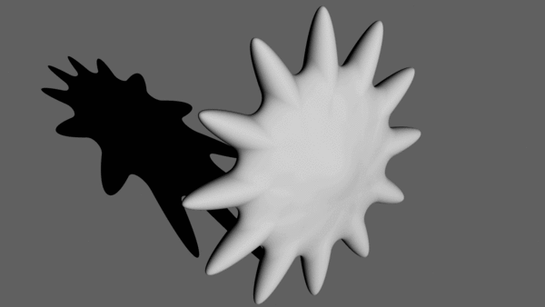

    For your cog rotation, for instance, the only thing that moved was the cog. That makes it eligible for using partial turns to simulate full rotations. If the camera was moving too, then this would present problems. If the material was changed, as you did for the second attempt, this would also influence whether or not you could use partial turns for full rotations.
    Have a look at this: Oro's Partial Turn Study
    The bottom line is: your first animation used 97 frames and I can spot the loop point every time. My cog is higher resolution, smoother motion, yet used __ frames (watch the video to find out :) ) The take-home message is: when making animated GIFs, have a look to see if symmetries and continuities are actually helping you reduce filesizes, and plan for smaller sequences.
    I changed the material on my Chain Gear and I think this material looks much better.
    It DOES look much better! But the material now makes the cog unable to take advantage of partial rotations, because the cog is now effectively asymmetrical. This isn't a bad thing at all, it just means you have to create more frames (a full turn) to ensure the illusion of rotation is preserved. Part of your task in creating looped animations is deciding what you think is best.
    EDIT: Attached is my cog in GIF format (I also slowed it down a little, but it still has exactly the same number of frames as in the movie) and is 1280 x 720 pixels. It's 1.2MB. To compare, Guss's first cog animation was 6.1MB. Mine is about 2-3 times the dimensions of Guss's first cog, but Guss's has more colors and detail. As I say, it's all about weighing up pros and cons.
    (My animation may look wobbly in the attachment window - this is a browser window thing. Click the image for wobble-free viewing :) )
    1280 x 720 - 1M
    Post edited by Oroboros on

    Tonight's experiments are along the same lines as I've been looking at recently with mechanics and machinery.
    This time my objective was to turn rotational motion into lateral motion using only rotation key frames.
    I came up with two solutions (neither of them revolutionary - no pun intended). The first is still an arc, which has it's uses but the second is true lateral motion.
    Created from 2 counter rotating discs with an eccentric axle.
    https://www.youtube.com/watch?v=ZGDrtdByPHY

    @Dave: I'm sure I'll have more questions. I usually do. Both of those experiments are neat to watch.

    Sorry Mermaid, I didn't mean to ignore your point. :)
    Yes, the second one is a bit shimmery (even though I switched off soft shadows to reduce render time) because the reflections in the metal are a bit grainy. I rendered the second one at a smaller size than the first and at a lower RPP. I think if I'd have rendered it at 1280x720 at 256RPP it would get rid of all the shimmer.
    Sadly, that would have taken a day or two and not the one and a bit hours it took. :-)
    Did you ignore my post... well I didn't notice that ;) I like your new video does the action speed up a bit at 0.18 or 0.19 then slows down again at 0.29 or 30, or my eyes playing tricks with me.
