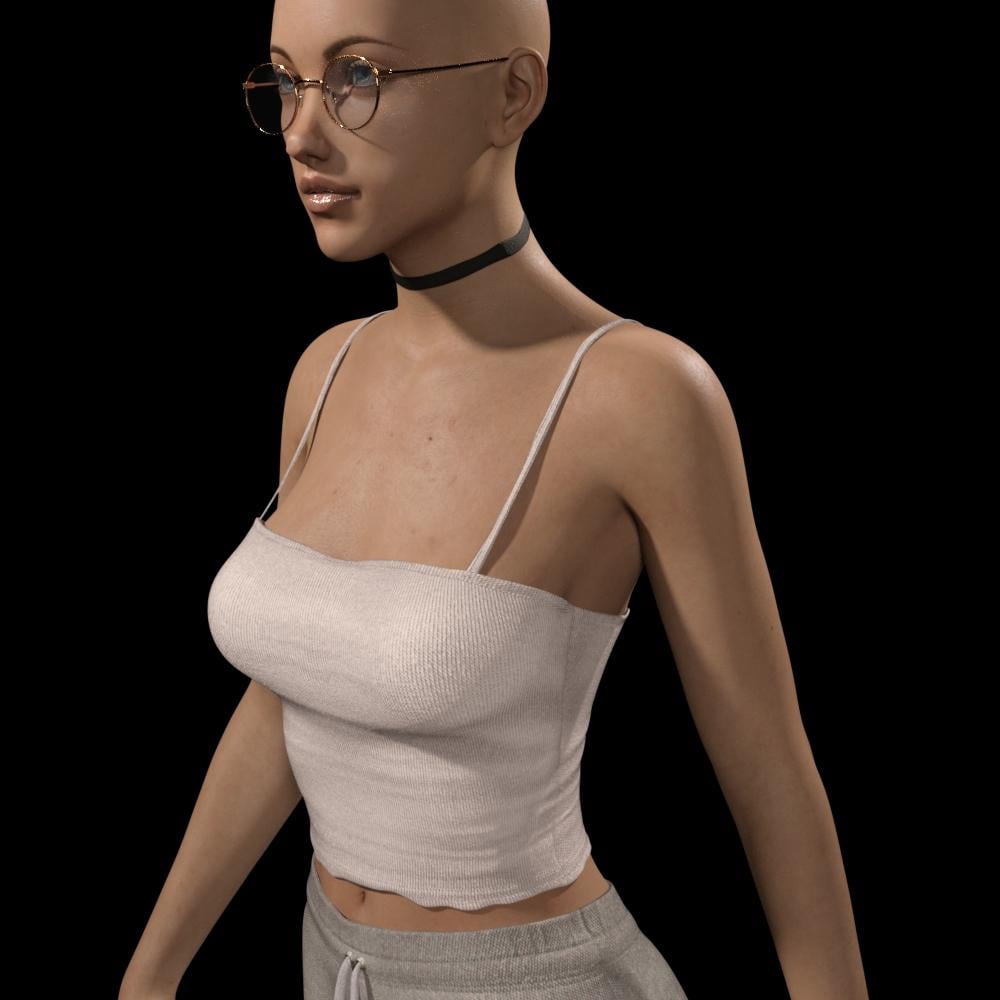

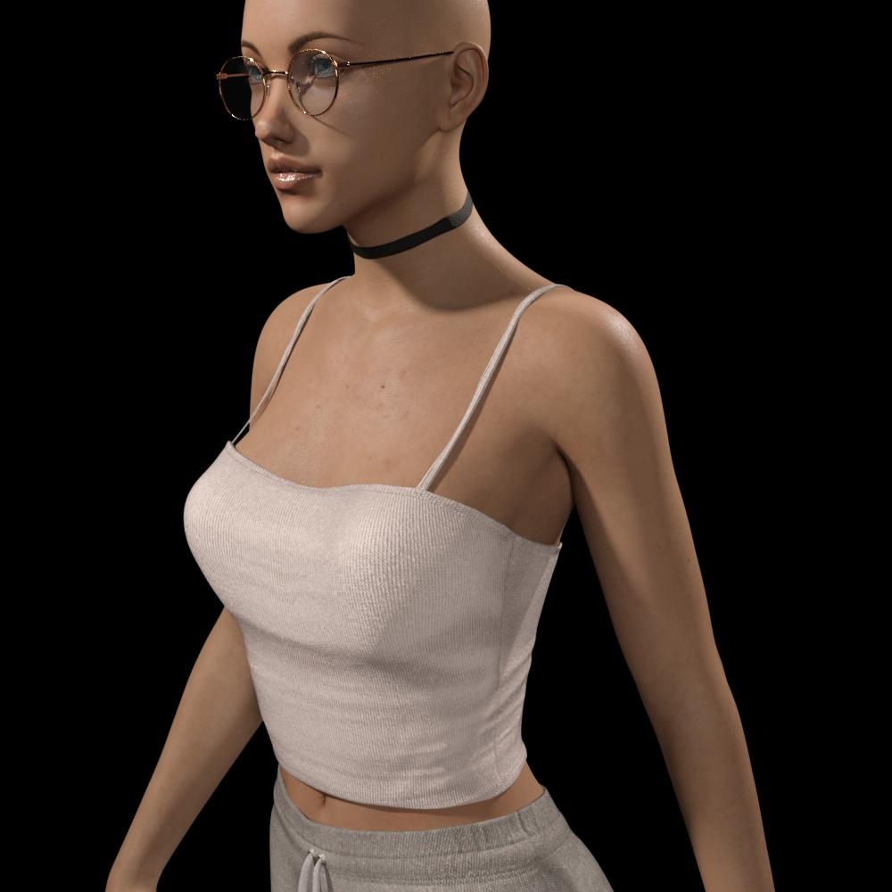

    Here I applied a dForce modifier, then added a dForce weight node from the Create menu. With the Node Weight Map brush right-click menu I selected by surface>Straps and filled with 0, then I used the brush to select some polygons in the top edge of the band and filled those with 0. The rest of the tube and most of the top edge retained a strength of 1. For the second attempt, I selected the straps by Surface, then deselected the bottom two rows of polygons on the ends and filled the remainder with a weight of 1 - then in the Surface settings I set the expand/cotnract ratio to 90% (a lower value might have been better, but care needs to be taken not to overdo it and I was just doing a quick test - hence the model's extrem buzz-cut) and the Collision Offset to 0.15 (as otherwise the shorter length of a lot of the edges would have been fighting the simulation). The straps don't have a back, so they lose thickness in simulating but don't explode as readily as straps modelled in the round.
    Top excluding straps dForced:
    Top including most of straps dForced

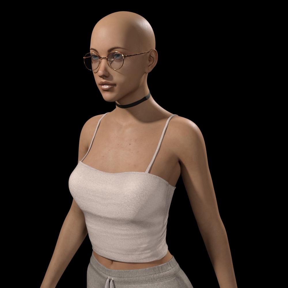

    And since I cant resist fiddling, here the Expand/Contract on the straps has been set to 8%% and I've set the front and back to 95%. I also added some Breasts Natural to Gensis 8 Female, so it isn't an entirely fair comparison.
    1000 x 1000 - 293K
