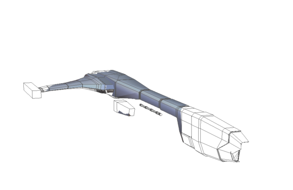

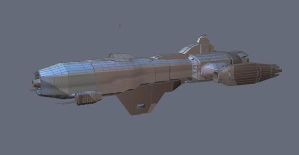

Any one interested in a collaboration
OK So I gotta admit UV mapping isn't my thing at this point would anyone be interested in helping me map this and possibly texture with an eye towards getting these models into the store.That way I can concentrate on the modelling.
Thanks for your attention.
Mickey
