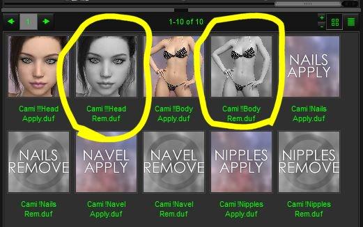

    The second thing to try I forgot to menetion was choose a character  that has a reset morph in its library  and just reset the head morph using the character  head remove reset preset , see screen shot  you can choose to just reset the head  that way as well. but those character reset prests will just return the head morph to the default character base morph , most characters bought in the daz store has morph remove preset for them

  • Ivy said:
    Ok, if I understand you both correctly, I cannot restore selectively. Will have to redo the morphs for body parts that are ok, hmm.
    Thanks a lot, much appreciated - will take your tips with me, and work some more.
    Kind regards,
    Mi
    Those should remove only the properties set by the character, not others.
