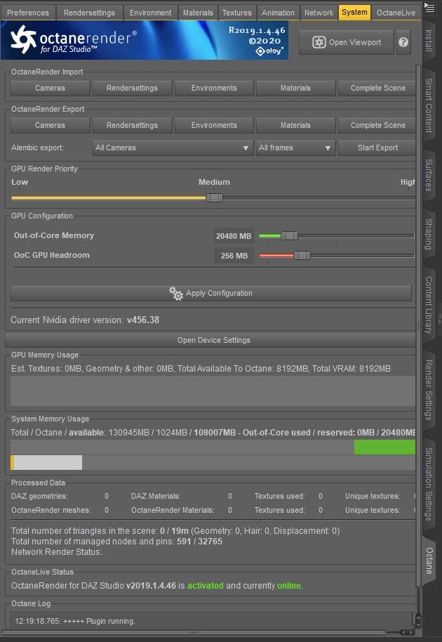

    You might want to check your GPU (memory) Configuration (see below) to ensure you have enough system RAM allocated in case you run out of GPU memory (not sure this is the problem, but it's worth a try). It might be possible that the particular house model you are trying to render has some odd geometry that Octane doesn't like (not something I've every run into or heard anyone having problems with, but it's within the realm of possibilities).
    Hope this helps!!
    630 x 914 - 122K
