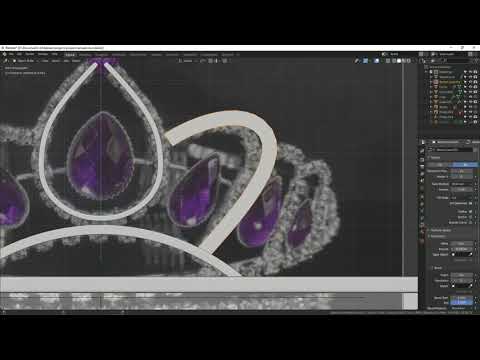

    If you want to learn to model anything, the first site you should look is Youtube:
    Image should only be used as a reference.  You can't cheat by wrapping it on a cylinder.
