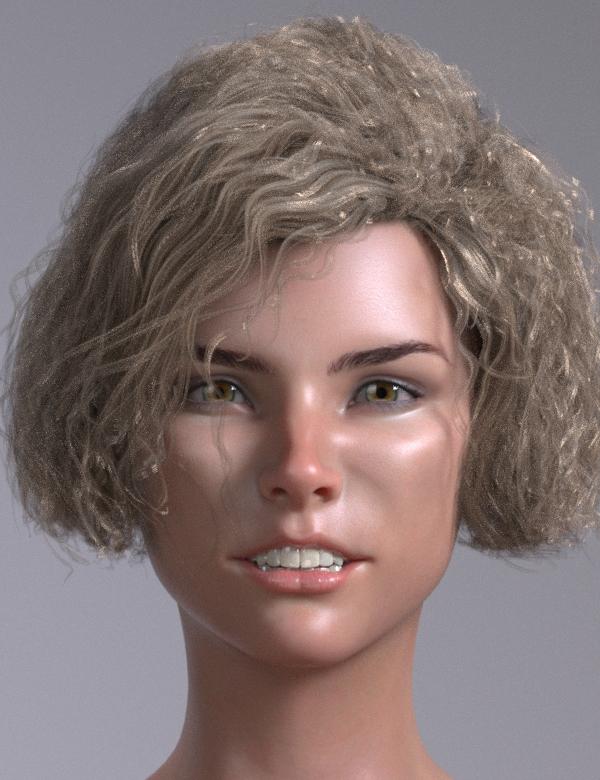

Hi everyone,
I am trying to use P3D's Soft Expressions Collection 2 but I can't seem to get them to look like the promo picture. I'm using the model in the picture (P3D Aria) and when I apply the Smile presets, they just don't look right - at least compared to the beautiful smiles shown in the promo images. It's probably just user error but I'm curious if anyone else has this issue? Maybe I'm doing something wrong?
Here's the promo I'm referencing:
And here is what I get when I apply the "SE02 Smile_02" expression preset:
This issue happens on other characters, too. Their mouths are always hanging open instead of being a mouth-open, teeth-showing smile.
This is what the preset icon shows:
Sorry if this is a simple issue to fix, I'm used to working in Blender so I'm not 100% familiar with everything in DAZ yet.

    @fastbike1 Thanks for the response. The character is P3D Aria. Here are my steps:
    1. Open new scene
    2. Load P3D Aria
    3. Load expression "SE02 Smile_02"
    The result is what I showed in my screenshot in the original post. I even tried the expression on the Genesis 8 Basic Female and get the same issue. See below for Genesis 8 Basic Female with the SE02 Smile_02 expression applied and nothing else:
    It looks a little less weird than the P3D Aria character, but still doesn't look like the promo images nor the thumbnail for the expression shown in my original post.

    @Sevrin Thank you for letting me know it's not just on my end. I've tried using the dials for other similar expressions - for example Playful_04 has an open mouth smile. Both the dials and the one-click expression for that seem to be accurate to the thumbnail picture:
    It looks like every other expression works accurately. It's just Smile_02 and Smile_04 that don't (in my opinion) look like the thumbnail/promo pictures. It's tough to pinpoint exactly what's different, but to me it looks like the lips aren't formed into as much of a smile as the thumbnail/promo, and the teeth are further apart instead of being closer together like in the thumbnails:
    Smile_02:
    Smile_04:
    I'm very happy with the rest of the expressions, but I'm disappointed that I can't get these two smile expressions to work because they're really good smiles! I was looking forward to using them. I've reached out to @P3Design on Renderosity to see if maybe they have any insight to what could be wrong.

    I had an idea that perhaps it was a matter of turning limits off, but that had no effect.   Nor does reinstalling G8F Starter Essentials.  What does have an effect is manually translating the teeth into position.
    This is from Get Real Expressions by the same PA, namely @P3Design  Note that the cheeks are a bit too high as well, so that's another thing.  This is with P3D's character Aria.

    Hi everyone, I am not yet sure what's the issue. It seems like another expression is dialed in as well.
    I have to state that an expression for Genesis can look different depending on the morph you use,that's why I included thumbnails for the standard Genesis 8 Female and used a morphed face in the promo's so one could compare. Some morphed faces are shorter and some are longer then the standard. This also counts for the hight mouth and teeth. That results in teeth being higher in the mouth or lower. In my morphs I always try to place the teeth as high as in the standard Genesis face. I dont know wether other vendors do this as well. So yes, sometimes, with some morphs, its needed to translate the teeth a bit manually. However, I tried this smile 02 with the Aria morph and at my end it looks fine:

    @Budsly Please try the following: start a new scene - select Genesis 8 Female in the scene tab - zero figure as in attached example.
    Then dial or apply SE Smile 02.
    Please do this on the standard Genesis 8 Female for by the look of it, your standard Genesis 8 Female has a different expression then mine when the smile is applied. So we can already exclude the P3D Aria morph, the issue you have  is  with the smile.
    After you did this step by step, can you please show me your render?

    The expression I used engages the morph Mouth Smile Open.  That, in turn, triggers a hidden morph eJCMNamMouthSmileOpen from the Nam Terror Set at 100%.  Now I don't know if you have that product, but setting that to 0% closed the gap between the upper and lower teeth.
  • P3DesignP3Design Posts: 132
    @Sevrin thats what's the case with Budsly as well. I asked for his log file and that's what's showed up. It must be an adjustment morph for the smile of a character that another vendor created. Do you owe any character with a name like that?
