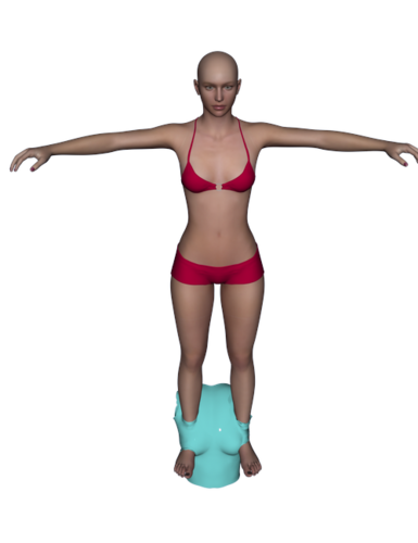

Hey all, first I'd like to thank all the people who came to my aid on modeling clothes in blender. I truly appreciate it. After I modeled my shirt and imported it back into daz studio everything looked fine. But when I tried to make the shirt pose with the character - i.e. transfer utility, it always drops the shirt to the floor and I can't move it afterward. So, what am I doing wrong? Thank you in advance.

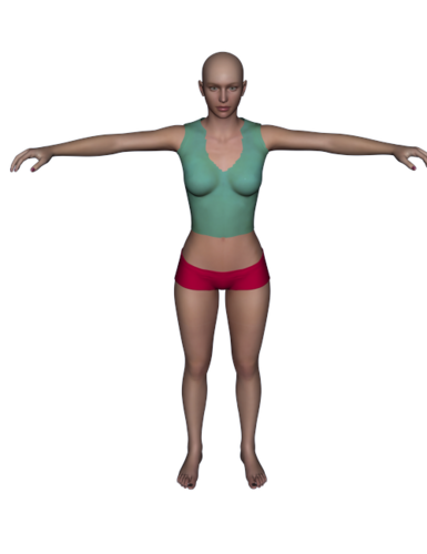

    This is the before pic. And what happens after transfer utility.

    The clothes need to fit on the figure without any transforms - if they don't, and you modelled around the intended wearer, then your preset in and out didn't match or your modeller applied a transform in one direction but didn't reverse it in the other. One fix is to line the clothes up in DS, export as OB, then reimport using the same preset (so, say, use the DAZ Studio preset for import and export).
    In other words, on import the .obj clothing MUST "land as desired" ON the figure. Then run the TU and it will stay put.

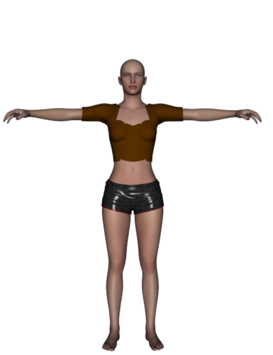

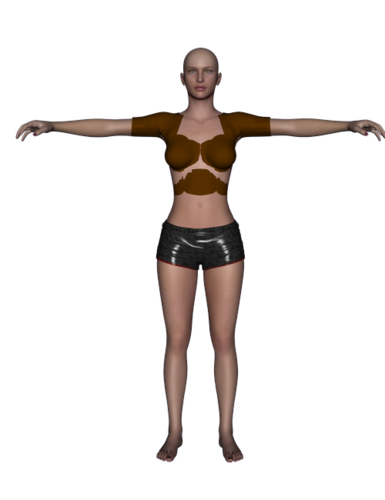

    Well, I thought it did the trick, but when I tried to make the real shirt instead of the test one - which I stupidly deleted without thinking I might want to check the differences - it keeps causing mesh collision when I use transfer utility. Here's a before and after. Thank you for your time.

  • Richard HaseltineRichard Haseltine Posts: 112,275
    Are you sure that's fitting the zeroed figure, not a morphed figure?
  • jboydston_jboydston_ Posts: 34
    As far as I know. It's just the basic figure, which I used to model the shirt from in the first place. If I scale it up, export it out and import it in again, it has less mesh collision. But that seemed like a lot of work, especially, since I have to just keep playing with the scale until it works.
