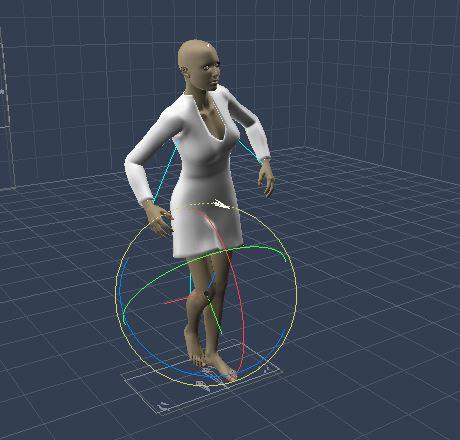

I made a simple dress in Carrara's vertex modeler. It is designed for V4, but my intention was to also have it "fit to" genesis characters. I converted the obj to a triax figure in daz Studio and saved it out as a wearable preset for V4. In Carrara, I loaded a V4 figure and the new dress figure. The dress conforms to V4 pretty well (see posed figure below).

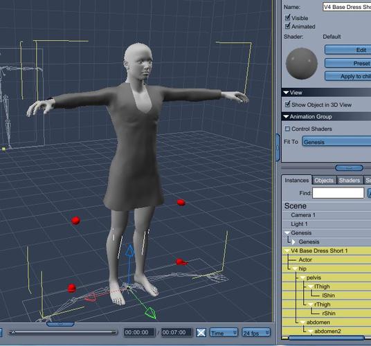

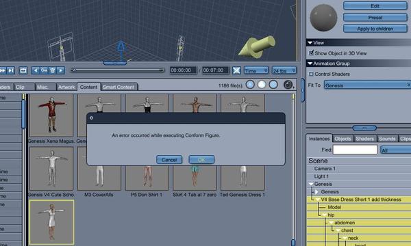

I then started a new Carrara file. I loaded a Genesis figure and the new wearable preset dress designed for V4. I used "fit to" hoping to get the menu that asks what figure the dress was designed for so it could be converted to fit Genesis. Instead, I got an unhelpful error message (see below). I also tried fit to in Daz Studio, but I don't get prompted there either.

    I'm not exactly sure about this, but I do have a hunch that the Auto-Fit is drawing an error from finding a Triax item for V4, since V4 stuff is not Triax. If you instead just made the clothing to fit V4 in the usual V4 fashion, it would likely work as expected.
    Thanks for the quick reply, Dart. I bet your hunch is correct. I took the mesh into Poser and used the wardrobe wizard to turn it into a conforming figure for V4. The result gets saved to a Poser runtime library. When I loaded the resulting conforming dress into the scene from the runtime library and used Carrara's fit to, I got prompted for the type of figure it was designed for. Carrara projected the appropriate morphs to fit Genesis.

    Cool. I expected as much, since I've taken a few looks at the mesh outcome after a Fit-To has been performed. Quite impressive, actually.
    So now that you've gone through the nice automated process of making a conforming Triax figure, instead of using Fit-To from V4 to Genesis, try reshaping your OBJ mesh in Carrara to fit Genesis Female or Genesis 2 Female, and then make it into a Triax piece. I forget how to do it when you make something for the female version of Genesis, but I think it's as easy as performing a subtractive process during the whole automated thing in DS. Then it will fit and work perfectly without the need for the conversion ;)
