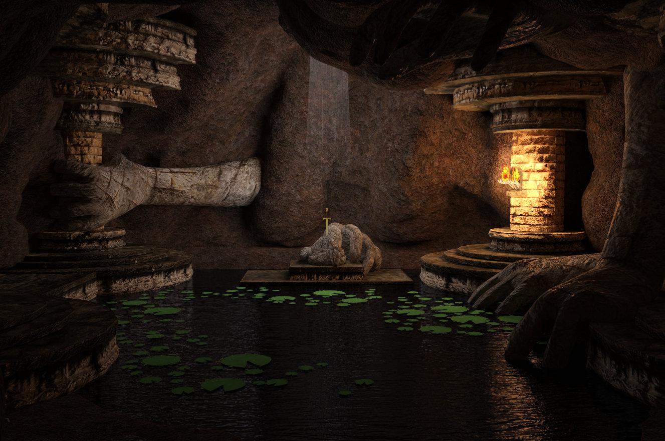

    I have this product, but until now I have never tried it out. Like others have said it is really designed for Poser, so some work is needed to look acceptable in DS.
    I rendered this in Iray, and I did not use any conversions scripts, I just applied the Iray Uber Shader over all surfaces of all the objects.
    First issue, there are no lights loaded by default, so I turned the torches into emissives, as well as the light beam from the ceiling. I then added a ghost light dome close to the torches to cast the bulk of their light, otherwise the flames will wash out if cranking up there own emissive value too high.
    I did apply a different shader to the water.
    The biggest issue was with cave walls, which look black and white. The base texture was odd, more like an opacity map. My guess is the walls used some sort of special poser shader node. Therefore I just applied a rock shader I have to the cave walls. The result is below. Not identical to the promo images, but not too bad. Change the color of the emissive lights if you want the blue/red etc look shown in the promo pics.

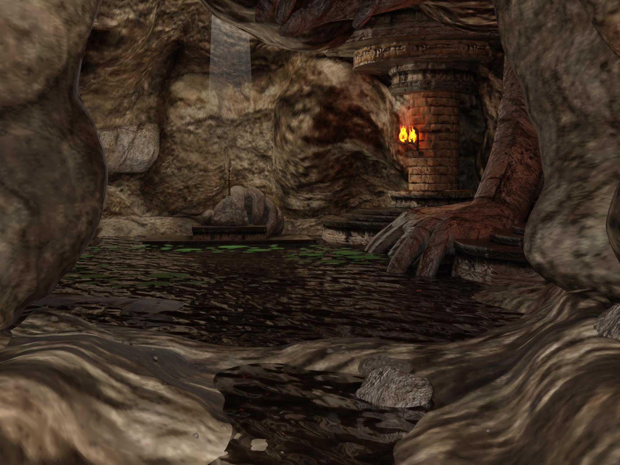

    Okay, there still seems to be some confusion about the product. Yes, it was made for Poser (.pp2) but also has a DAZ Studio script (.dsa) in the same folder that loads the DAZ Studio materials after importing the Poser props (check your log file after loading, it will pretty obvious). The 3DL shader for the cave walls is not the standard DAZ Default, but something much more complex, and will not translate well to Iray, if at all. The rest of the surfaces all use the DAZ Default shader, so shouldn't cause any problems. As previously mentioned, the Water prop gets a separate material preset from the StudioCF file, and uses yet another non-standard shader, but any water shader will do.
    There are two files for this product, "Strange Cave" and "Strange Cave StudioCF" (as seen in DIM). The first has the main scene in the Poser Formats section, and the second has the Water material in the Studio Formats section, because that is what it is.
    This is a 3DL render with three pairs of very bright point lights (for the torches) and render gain set to 4.

    I've done an Iray conversion, scene file attached. I hope this works for you. This uses the 3DL-Iray converter with a little bit of finetuning in regards to the water. The main issue was that you had to shuffle around some maps that got lost and some that had to be removed entirely (like the water mask). There was also some issue regarding non-subdivisioned geometry, which is bad for normals and displacement.
    You can probably improve on it using different roch shaders for the cave itself.
    EDIT: Here's a quick and dirty render.
