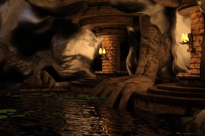

  • TaozTaoz Posts: 10,351
    edited April 2020
    I think it's difficult to get the same look with Iray, but you can make it look good.  I've used basically the same method as @Hylas describes here, but applied Iray Uber Base shader to everything first and the Swedish Green Rough shader from Hard Surface Shaders for Iray to the Cave Terrain (the default shader doesn't work well with Iray).  Otherwise nothing's been changed.
    1200 x 800 - 2M

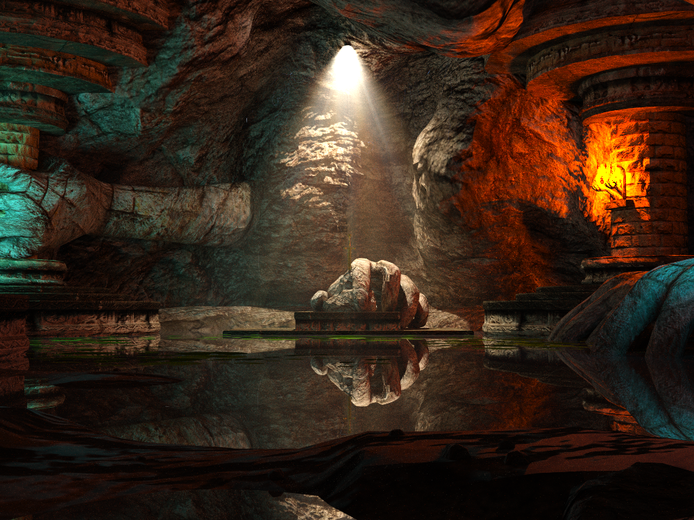

  • chris-2599934chris-2599934 Posts: 1,979
    edited April 2020
    Here's my version, just thrown together quickly.
    All surfaces converted to Iray uber base.
    Daz Iray water shader applied to the original water surface. I found it looked too choppy if I reapplied the original bump and displacement maps, so this has just the normal map applied with a strength of 0.1. I also set horizontal and vertical tiling to 5.
    The flames have their base color images applied to emission color as well, and the luminance cranked up to 150000. It still doesn't light the scene well, so I added a ghost light around each pair of flames.
    The set has a bit of geometry to represent a godray shining on the sword. I couldn't get this to work quickly in iray, I'd probably just replace it with a regular spotlight and a bit of fakery in post.
    So yeah, it works fine in iray with very little work required.

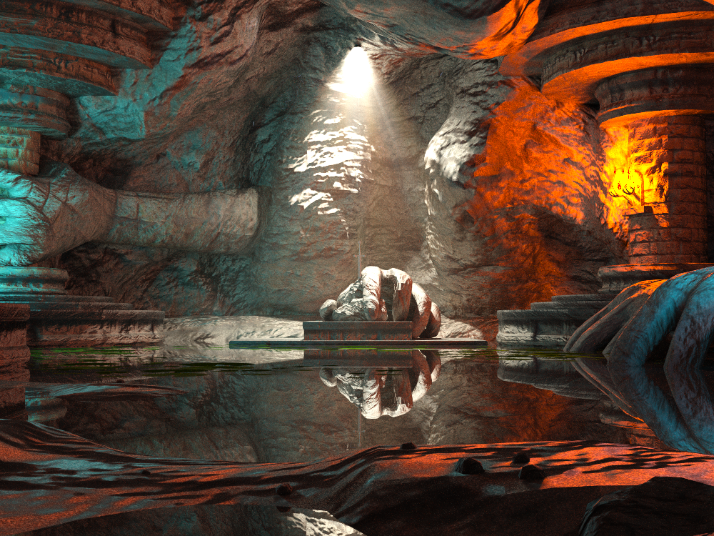

  • FenixPhoenixFenixPhoenix Posts: 3,245
    edited April 2020
    I was curious about this and, since I had the environment, I gave it a go. I added a tiling of four to the cave texture since it looked very blurry otherwise.
    Example 1. Transformed to iray by using the Rough Stone Shader Presets to borrow the settings and then tweaking from there. Added emission to the flames, applied an iray shader to the water, added two emissive blue lights from this light set on the side and replaced the volumetric light with a dispersive option from this set.
    Example 2. Added NGS manual script and tweaked from there. I think I needed to tweak a lot more to make NGS work with this set. But at this point, I prefer the previous version.
    BTW, for some reason, the proper base texture isn't applied to the cave when you load the product. Instead, a mask is applied where the diffuse texture should be. So you'll have to manually apply the texture map for that one.
