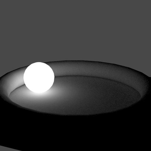

    thanks. in that image above the "sphere" isn't actually there (only the lighting was there..it was placed (painted after the fact) onto the render) I guess not a real good example of what i meant to ask..this is exactly what i mean..on this test render (done elsewhere) i placed a sphere where the flame is which rendered the lights,yet did not show the sphere..hope that made sense..

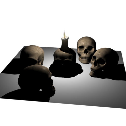

    Something like this? LinerPoint Light used here...
    Just a quickie for example, no Ambient fill light added to soften...

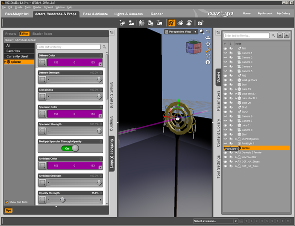

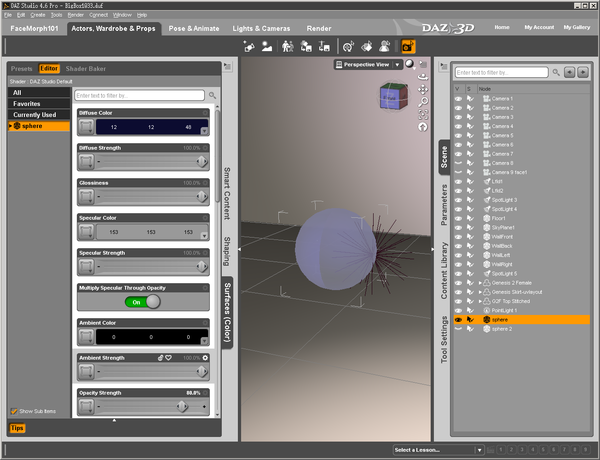

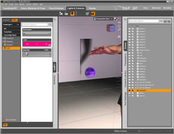

    I did something like suggested. Place a "Primitive" sphere in a scene as an orb (or your case the candle flame). Then I set it to less then 100% opaque (Opacity Strength), so the light and stuff behind the orb (or flame) is somewhat visible. Real flames are not completely opaque, lol.
    Then the light is a simple "point light". The color of the light, and the shadow can be set separately, to give it more realism, then my beginner attempts. (And that is basic lights, I have not dabbled with the "Obber" stuff yet)
    Also the 'scale' of the light (parameters tab) will adjust the size of the light source wire-mesh-sphere-thing...
    The primitive sphere (or flame) will diminish the light intensity if the point light is in the sphere, I compensated for this by putting the light just behind the sphere from the intended point of view.
    (edit)
    The sphere in the screen-caps also has the Reflectivity (further down in the "Surfaces tab) cranked way up to give it that glass ball look. You may not need that for a basic flame.

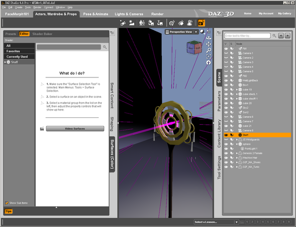

    And an example where I needed to make the point light larger 'scaling' for it to work in a staff.
    The light-beem is a primitive sphere stretched out using the x,y,z scaling instead of the over-all scaling (Parameters tab). Same consept of the translucent (Opacity strength) was used here.
