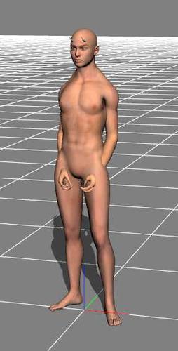

    Rottenham said:
    Well, I did it. I looked through this thread, watched a couple of vids, then ran a Genesis figure through 3DX. This is the first time I got this far. There are, of course, a couple of problems.
    The trapezius muscles are out of control, I don't know what that's all about. The hands are sticking through the legs, I may have seen a fix for that, I'll need to retrace my steps to find it. The viseme morphs made it through, but don't seem to be working. The body morphs work fine, but the face morphs do not work.
    In spite of these problems, I feel a sense of triumph. I think that in time, I'll get to the bottom of these problems. Any suggestions or recommendations would be welcome.
    you have to start with a T - pose

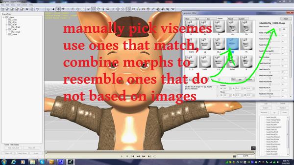

    Do you have the duf facial animation preset to apply to it in studio?
    That will zero out poses as well and set it up ready to go for 3dx5 no more adjusting in convert to nonstandard needed

  • WendyLuvsCatzWendyLuvsCatz Posts: 41,646
    Yes a very valuable file that
    Worth the $99 price tag in many ways and not quite so bad as you do get other content with it
    While it is possible to retarget stuff without it and manually assign visemes in expression editor, and indeed nessessary for other figures and animals it really makes using genesis a no brainer!
    I am only now embracing G2F & M more now due to the work involved manually retargeting them esp fingers though I did save a t pose that sometimes works right, the notepad edit of the duf swapping Ctrl for phm helps a lot but still a bit of tweaking in expression editor needed.

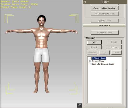

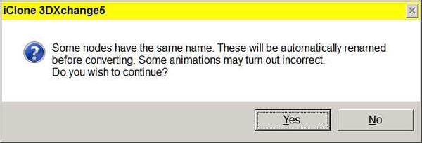

  • laststandlaststand Posts: 866
    Exporting a modified figure to 3DX is not working out. Hopefully, veteran 3DX users will see why. Here's what's happening.
    FIG 1 - The FBX has been imported, but not yet converted. Looks good.
    FIG 2 - Beginning conversion brings a warning about node names. I can see there is a conflict between the hair, the shorts and the figure, but other than that I am clueless.
    FIG 3 - Another warning, more wordy, less informative.
    FIG 4 - The result of conversion, in Head Calibration. Hair and shorts are animated, figure stands still. Note the weirded out ankles.
    I will need to learn how to fix this, in order to bring in characters with hair and clothes. Where to begin?
    534 x 455 - 23K
    627 x 269 - 29K
    625 x 213 - 20K
    535 x 453 - 21K
    It can interfere with the fitting in FBX
    Also does in Carrara duf import
    You can see the extra set of bones
    Also there is a setting in FBX export
    You MUST merge skeletons
    Wo! Did THAT make a difference! Merge Clothing into Figure Skeleton! The error messages were trying to tell me that, but they were too inscrutable. And I don't have enough time staring at the 3DX skeleton display to know what I'm seeing. The calibration motions all work fine now, and the hair and shorts behave well.
    Thanks for this!

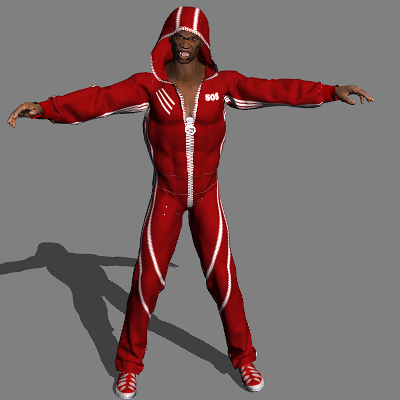

    I thought I'd post the results of my Genesis into iClone adventure. I'm pretty happy with the way this worked out.
    Thanks for your valuable help, wendy♥catz.

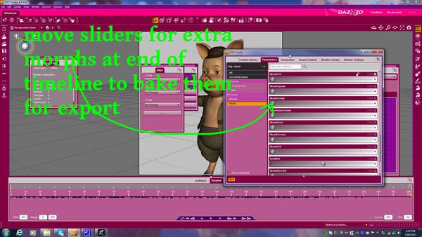

    It actually comes down to how iClone 3dx5 reads the morphs or rigging on the timeline using the genesis preset as well as having movement in the beard.
    The expression editor morphs do not intact use the figures rigging and appear in a set order using that duf facial animation file 3dx5 detects and assigns them as they occur baked to the timeline.
    Any other morph movement on clothes hair and beards if done gets baked at same time
    So if you flip her fringe at the frame "CH" appears she will flip her fringe pronouncing CH etc
    Tweening also comes into play here.
    Morphs can be put into the beard using transfer utility, the Mec4D M5 fibremesh one actually has morphs already so no need on genesis.
    But it needs to be manually key framed on timeline for 3DX5
    And best done on its own in the same position as conformed to your character and the exported FBX loaded on it in expression editor as the file is so big otherwise it will crash 3DX5
    Unless you tediously match all 57 frames of the duf with each morph zeroed before and after the beard will not line up with the expressions anyway so a seperate fbx import in expression editor add tab best.
    Then you manually dial them in for each viseme, mouth movement etc.
