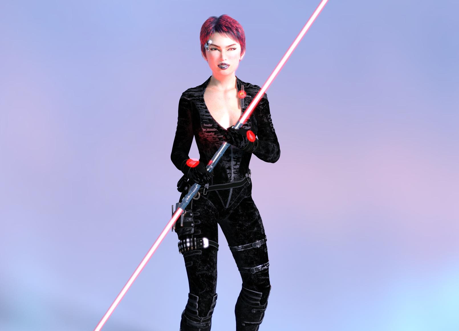

    I have all of those except for the combat rifle poses, went through every G8F pose, and they all work for me.  I think the first thing I would try is to right click on the pose to browse the the proper location for the file and make sure it is showing in the appropriate character's  library or better yet, load your figure and apply the pose from the library so that you are certain you are getting the G8F pose instead of the G3F pose. Also, select the pose in Smart Content or Library and look to see what it says in the Info tab.  Zeddicus is pretty prolific and I haven;t heard of this as a problem.  Here is a render showing a pose properly applied.
