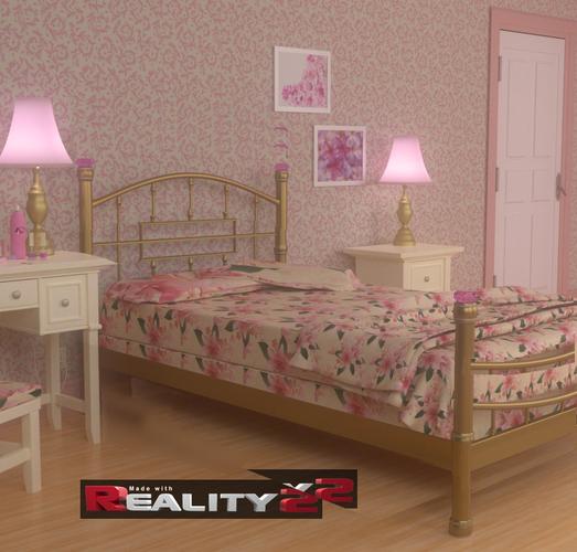

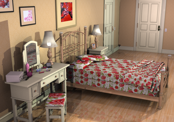

Howdy y'all
I'm trying to release a free when it's finished project that will work in DS4.5 for Reality2 or UberEnvironment2 without the need for users to go crazy in setup.
So far I have 3 nulls in the content, one for the bedroom, one for the 3Delight lights and one for the Reality2 lights.
My understanding in Reality is I need to reimport all the obj's from Blender back into DS before I can create ACSEL textures that anyone could get off the ACSEL sever
My other understanding is anyone with DS4.5 or up should have the UE2 lights but I don't know for sure.
When I save this scene I assume I need to go to "Support Asset...Scene Asset(s)" then include the textures, and the obj in the geometry folder but is this the right way to do this and do I need to provide anything else in order for the scene to work on anyone else's DS4.5? I'l also include the OBJ's for Poser users but I won't be able to set up anything since I don't own Poser past version 5 and I don't have it installed on anything either.
Does anyone have experience doing any of this that could guide me through the right process?
I may add one or two more items to this set to "punch up" the room a little more but I don't want to get caught in a spiral of home decorating but here's what I got so far:
1366 x 962 - 336K
1370 x 966 - 398K

  • Faeryl WomynFaeryl Womyn Posts: 3,784
    I don't have Reality so having them for UE as well is great. I hope you get it figured out. You could try asking in the commons for help, someone who knows will answer and there usually isn't too long a wait depending on what it is.
  • MBuschMBusch Posts: 547
    Hum, I very like the UE2 render. Anyway, the are something weird with the Reality render. The metal is more realistic in UE2 version while Reality is always very realistic with galss, mirror and metals. I think you let the metal surface as glossy or if it is setup as metal so it has little shiny
  • MilosGulanMilosGulan Posts: 1,993
    It looks very nice. I like both renders, i also have UE2 but second render made with Reality 2 looks fantastic :)

  • TimbalesTimbales Posts: 2,457
    Looks really nice.
    My only suggestion would be maybe a small rug and a few more plump pillows.
  • StratDragonStratDragon Posts: 3,290
    @MBusch,Gulan7
    the metals in the Reality image are rendered for less than an hour which any Lux user can tell you it's not even warmed up yet. I rushed that piece, it' also has a bloom (blur) to soften all the parts of the render that needed some more time in the oven so that piece is seriously "undercooked". However UE2 does do a wonderful and far faster job of metals with some simple shader adjustments and that's why I want both Reality and UE2
    @TimG
    More pillows? Ok I've been working on framed art and honestly the pillows in there now were an experiment with the fabric simulator in Blender after one youtube tutorial so I'm open to other possibilities and scrapping the ones I have in there now.
    I'm running into issues with the data files, this is turning into a bigger project than I expected but I may release a single OBJ with all these pieces in place if anyone needs a big static room that would prevent remodeling but keep in simple if the current arrangement works.
    Heres the piece allowed to bake a little longer, the metal on the bed and lamps was purposely muted
    951 x 932 - 1M

    Nice render indeed! Good job!

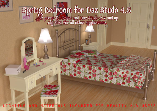

    almost there,
    I'm really starting to like UE2 again for lighting.
    1370 x 966 - 2M

    Link on ShareCG
    http://www.sharecg.com/v/76271/view/5/3D-Model/Spring-Room
    Link on Renderosity
    http://www.renderosity.com/mod/freestuff/?item_id=73967

    Nice work StratDragon. Thanks for posting. :-)
    Thanks for this, it looks great. I found it on Renderosity and will DL it now.
