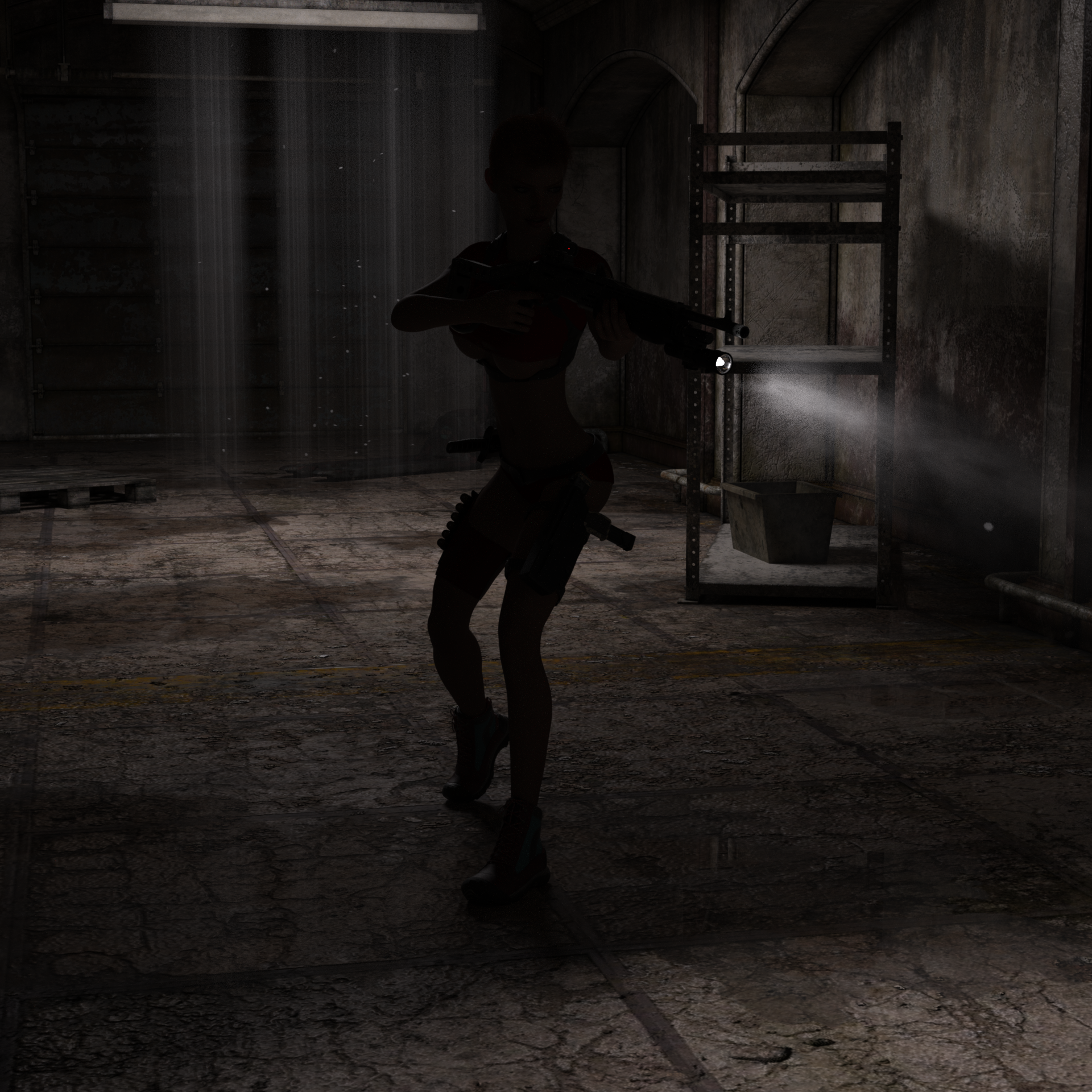

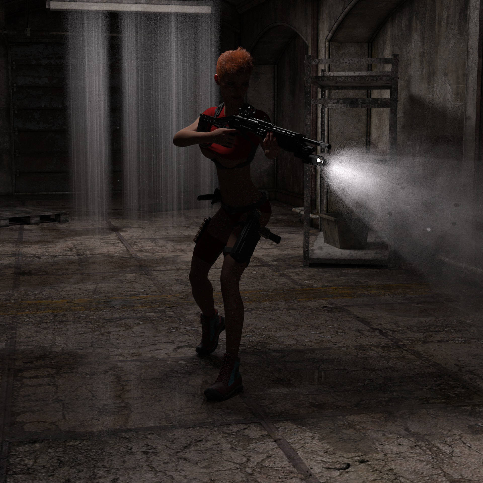

    I ended up buying the Ghost Light 3 set. Works pretty well. I've attached a couple sample renders.
    1920 x 1920 - 4M
    1920 x 1920 - 6M
  • Steel RatSteel Rat Posts: 417
    Thanks for the replies!
    The one on the left (Rendered to 95% convergence) I had turned the intensity down, since it looked initially like it was going to be too washed out. The one on the right (Rendered to 40% convergence) has higher intensity for both ghost lights, and I added a non-volumetric ghost light just above and behind the figure.
    I woouldn't say it's a perfect result, but very goo with initial fiddling. There are lots of paramaters to adjust the shape of the cone and particle intensity and such. It's a good set. Thanks very much Nemesis10 for the suggestion.
