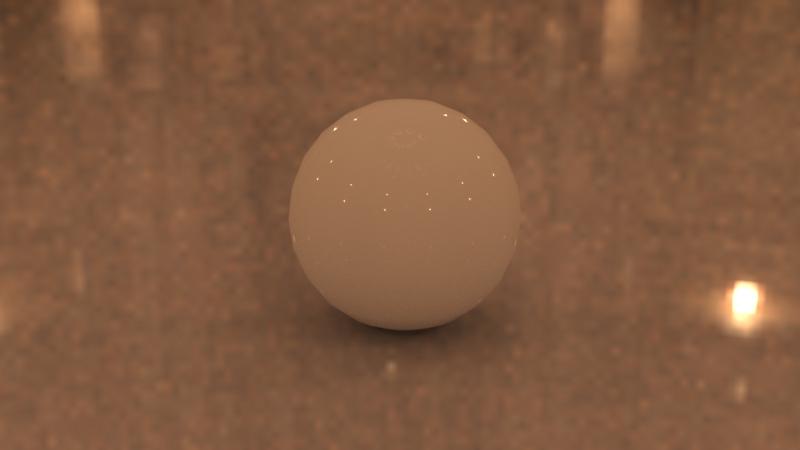

    Step 2: Tone mapping: Crush blacks 0, Burn highlights 1, Gamma 1 (optional in my experience)
    Step 3: General render settings: Aspect ratio 2:1.  Pick your size.  Bigger = better, and also lots slower to render.  If you don't want to see details, a smaller size should be okay.
    Step 4: Set up your camera.  That depends on your scene, and what your POV will be when you do your scene.  For general purposes, zero out translations and rotations.  Depth of Field off (your choice!).  Lens - Lens distortion Spherical.
    Step 5: Render Settings > Advanced > Canvasses Check canvases.  Click the plus sign to get a single Beauty canvas.  That should be all you need, unless you want to play with lighting.
    Step 6: Render and save your render.

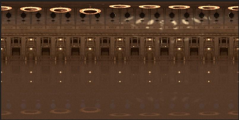

    Step 7: Open the EXR file which will be in a folder wherever you save your renders.
    Step 8: It looks like this
    Step 9: Reduce exposure to taste.  Something around -11 to -14.  You get this.  In this case Aslan Court 2, with whatever lighting came with it.
    Step 10: Export as HDR.
    Step 11: Select that HDR as your environment HDRI and put a sphere in the scene and it looks like this.  Here the HDR is 800x400 because it's too hot to render for hours, so it looks really bad.  You get something like this.  Whatever lights you had, are now affecting the sphere.   I'm no expert, so DOF may or may not work. ¯\_(ツ)_/¯
    Actually, more like this, if you use normal gamma
