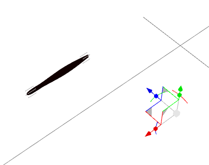

So, this has happened before, and now it's just annoying. I recently bought this, a DAZ product:
http://www.daz3d.com/medical-tools-1-surgical-tools
The props are significantly offset from their points of origin. See the attached screenshot. This is especially troublesome for objects that require a lot of subtle manipulations (like these). How can this be fixed? I tried editing the values in the pp2 files directly, but I just don't know enough about how they work.
Any help?
430 x 340 - 7K
  • Design Anvil - Razor42Design Anvil - Razor42 Posts: 1,250
    I'm not really aware of anyway of correcting this within Daz Studio itself unfortunately.
    The way I do it when preparing props if I encounter this issue is to manually place the prop in the centre.
    Then Export the prop to obj. Then reimport using the same scale values paste on the materials from the original.
    And resave as a new prop. This will correct the handles. (This will also set scale or rotation changes as default)
    This process can be a little tedious with a large number of props and you need to be familiar with saving props in Daz Studio.
    I do hear your pain when trying to manipulate an object when its handles are way of centre.
  • Richard HaseltineRichard Haseltine Posts: 111,996
    You can use the Joint Editor to move the centre point - the green blob with axes sticking out.

  • AinTunezAinTunez Posts: 38
    That definitely helps, though it can be a bit tricky to get right. Most DAZ originals are great, so I'm honestly surprised that this kind of thing wasn't caught before release.
