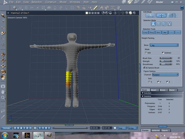

Just curious whether anyone has recently rigged a figure in DS and exported as cr2 for use in Carrara?
I used to do this a lot because I much prefer the weight-painting and constraints setting. Haven't done it in a while, though, because I've been concentrating on hard body modelling.
Just finished making a dinosaur, which worked perfectly in DS, but did some really strange things in C 8.1, so ran some tests on a simple figure.
The cr2 works perfectly in DS, but in C, whether using Tri-Ax or parametric, in most cases, but not all, it reads the bones hierarchy wrong; for instance, the weights for r-leg is allocated to r_thigh - always one up in the hierarchy and the child bones are not attached. In other cases, such as the shoulders, it reads and behaves correctly.
I'm just wondering whether this works OK in C8.5 and Daz has just made 8.1 redundant for this purpose?
1024 x 768 - 184K
1024 x 768 - 162K
1024 x 768 - 204K

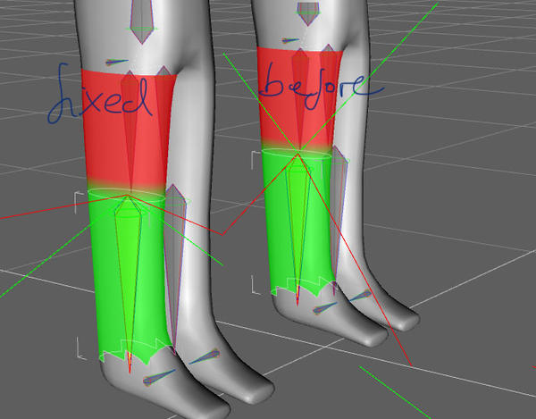

  • fabafaba Posts: 53
    Hello Roy,
    When I open the file in DAZ Studio and watch the weight assignments I can see that lines that show the static/ posed angle are flipped (red is static, green is posed).
    I attach a screenshot
    When i fix the angles (red to static/ green to posed) it behaves in Carrara as expected.
