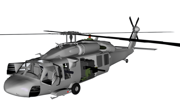

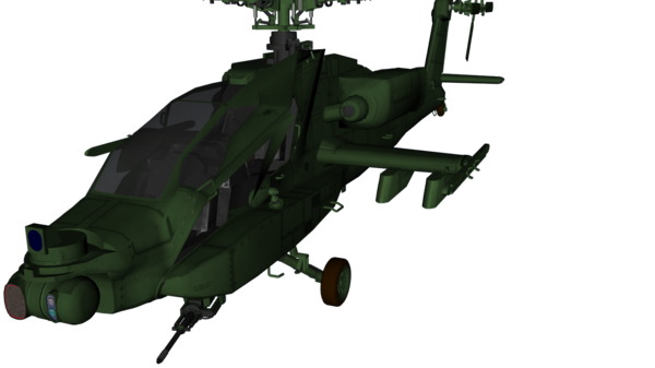

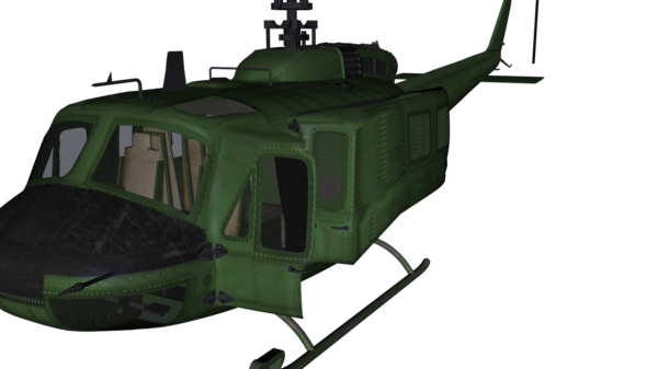

The Daz Blackhawk is an excellent model but every time I load it and open up doors this happens and this also happens with two other models. What is going on here?

    Looks like a problem some other models have had. They required updating to the newer programs which apparently handle groups a little differently. Not all .cr2s were created using the very same methods. Might be a good idea to shoot a note [politely] to CS.

    This sort of thing happens when the model is made with parts not fully separated - if you need it before it can be fixed at DAZ you can do so in many modellers by selecting the door or whatever, cutting, and pasting back in place - just check that the UVs aren't destroyed first, which will depend on the modelling application used.
    Okay let me see if i understand...i cant fix it in Daz but I can fix it in another modeling program?
    Yes.
