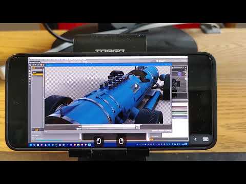

    RobertDy - I only use Splashtop Android to check rendering status. If I wanted to work this way I would connect a 4K TV, Bluetooth mouse and keyboard.
    If you do use DAZ Studio with ANY Splashtop remote, remember that if you are using a manipulation tool like rotate model (left click rotate icon and drag mouse), and your cursor goes off the screen then DAZ Studio is still active and your model will start spinning like crazy.
    Here is a video of me running Splashtop on my Android cellphone. Also make sure you are in mouse mode in splashtop, not touch mode.
    In the video you will notice a lot of lag between the remote cursor and my phone cursor. It is because my cellphone provider is still using tin cups and strings for our service. I can use Splashtop in my small town of 10,000 people, but it requires patience on my part.  :-)
    One way to minimize the crazy mouse issue, is the use the VIEW tab in DAZ Studio and place the window near the center of the screen so when you drag you have a greater distance to the edge of the Splashtop window.

    Your answer on how to solve the mouse going crazy bit is the real deal and I can't thank you enough for it! With this I can say that Splashtop is the best remote program, and probably the only one that works. There's just that tiny little problem about the phone's very large cursor that obscures the remote cursor, but that shouldnt be too big of a problem. Now, if only Parsec was free...
