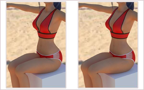

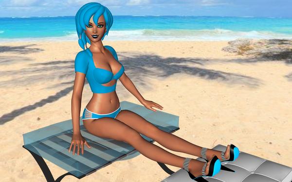

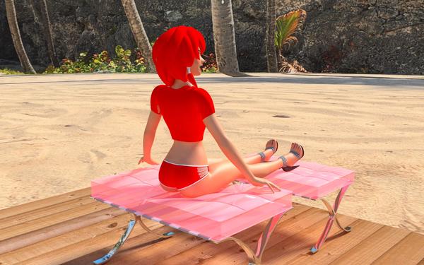

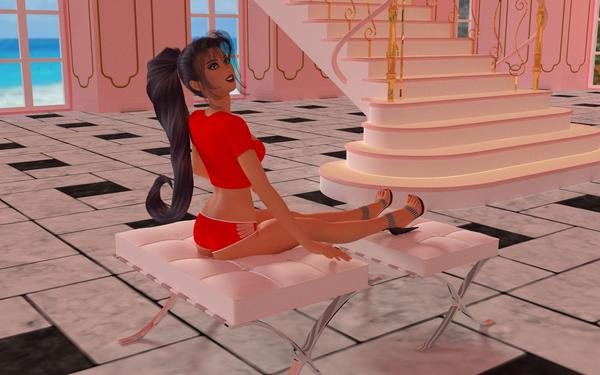

Ready - a morph and a d-form to address Aiko3's flat-thigh-top issue
mCasualmCasual Posts: 4,607
edited July 2014 in Freebies
well in the end the solution i give you is a d-form, packaged as a morph
i also include the d-form as a dsa file
it’s not perfect, but it does de-flatten the thighs and gives mildly accemptable results smile
https://sites.google.com/site/mcasualsdazscripts4/mcja3sitmorph
1920 x 1200 - 169K
1920 x 1200 - 224K

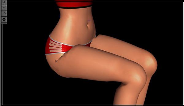

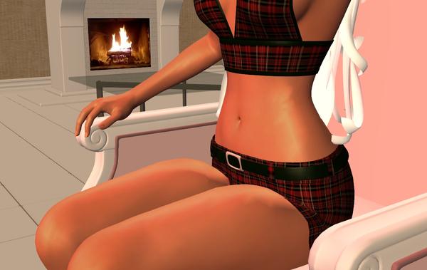

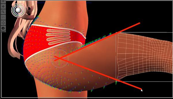

    quick study
    the flattening is linked to the thigh rotation
    here you see a target curve similar to what i'll use
    1188 x 660 - 106K
    600 x 337 - 389K
    Post edited by mCasual on

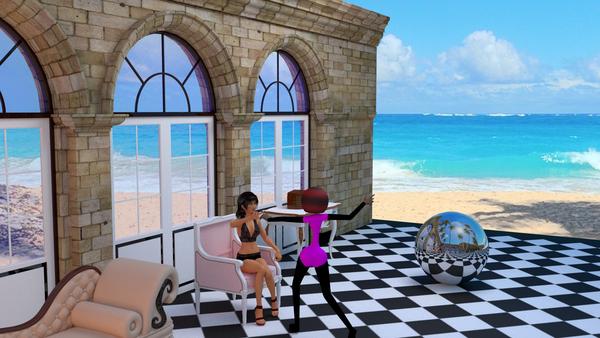

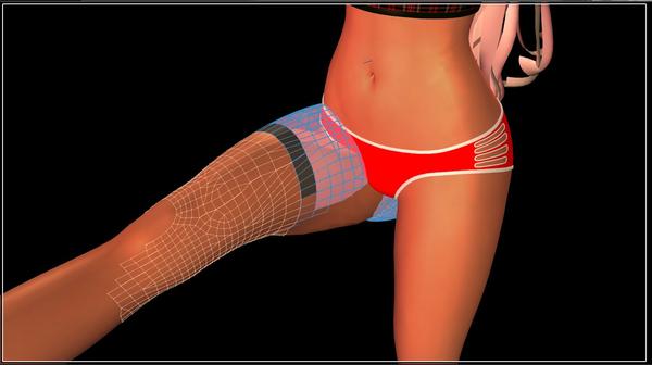

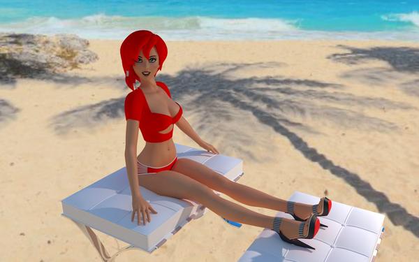

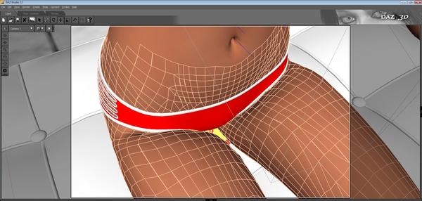

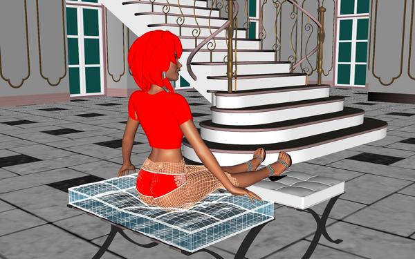

  • mCasualmCasual Posts: 4,607
    edited April 2014

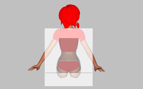

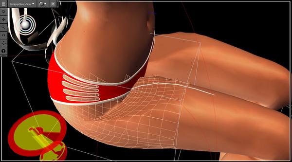

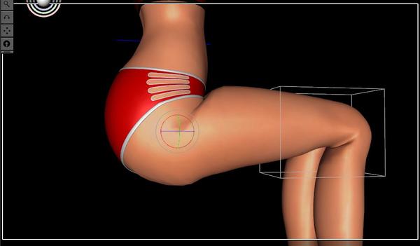

    spending a few minutes on the flatthigh tops issue :)

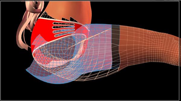

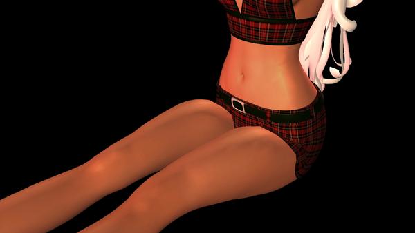

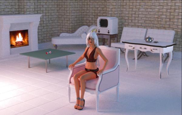

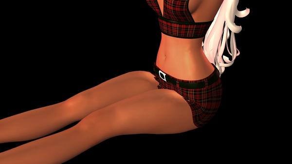

    figure 1 : null nodes are marking the buttock vertices that are not simply rotated-around-the-thigh-node
    shown below is the script i used to obtain this
    in figure 2 we will see what their positions would be if they were ... simply rotated-around-the-thigh-node
    so the solution will probably be to generate a fix-morph using a carefull blend of those displacements
    ... but that will be next time !
    figure3 and 4 show the buttock shell parented to the thigh bone and rotated along with it
    and figure 5 shows that a lot of things are going on when the thigh bends

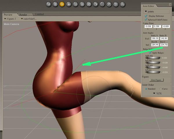

    edited April 2014

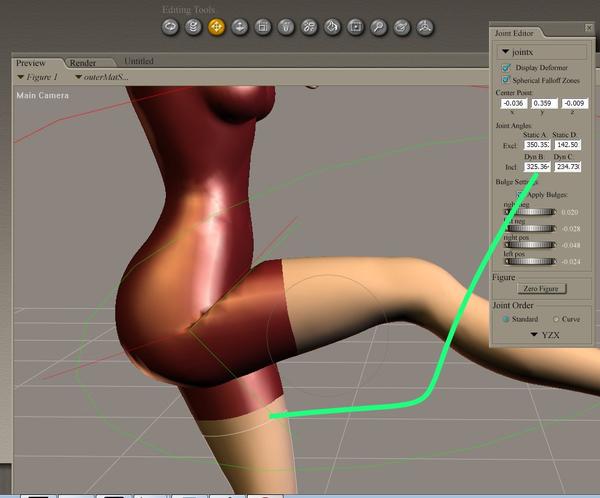

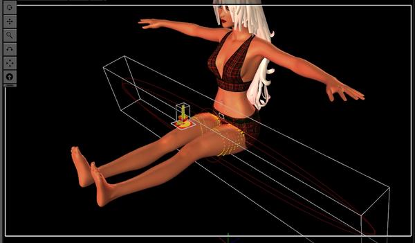

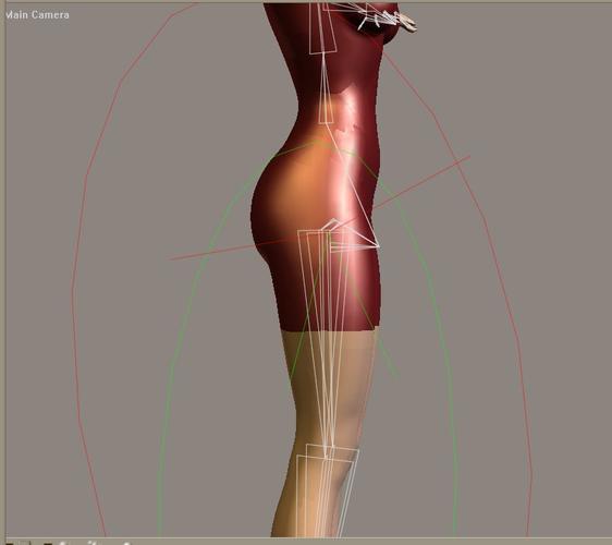

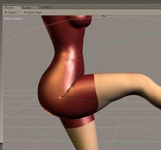

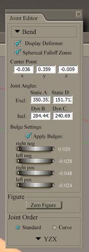

    in poser (7) we can see the red/green lines which delimit the regions under the influence of the thigh Bend
    now ... what if we move one of them? ( by now poser probably destroyed aiko's rig )
    fig2 ... interesting no? it doesnt look too bad
    and somewhere in the CR2 those angles can be changed
    it can possibly be done using a daz script "live"
    i didnt know it but you dont need to be in Poser's setup room to use the Joint Editor
    which is a good thing because entering the setup room is extremely scary for the Aikos of this world
    Fig 3 - apparently the angle is called Incl(uded) Dynamic C
    Fig 4 - changing the other green like, removed much of the back-oof-the=thigh bulge ... interesting results here too, with a minimum of effort
    Figure 5 - that's the initial vialues for - so we just have to locate those in the CR2 ...
    the changes to make for the right thigh bend would be something like
    284.443 --------> 337
    240.691 ----------> 225

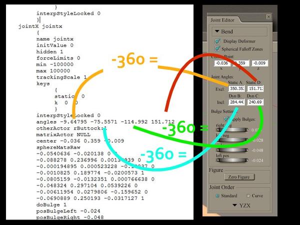

    so i make a copy of aiko's cr2 which i call aikoMissThigh.cr2
    i open it in wordpad
    i look for actor rThigh
    ( is it me or didnt wordpad handle humongous files well in XP and not well at all in Windows 7? )
    and within rThigh i find the "JointX" channel which holds our angles ! albeit with a 360 degrees offset ( probably to keep angles between -180 and 180 )
    so uhhh i change
    the second value (B) from -75.5571 ( = 284 - 360 ) to ( 337 - 360 ) = -23
    and i change the third value (C) from -114.992 ( = 240.691 - 360 approx!? ) to ( 225-360 ) = - 135
    save, load aikomissthigh in DS3A and it ......... didnt work
    so i search for the angle 9.64795
    and i find 4 occurences of a jointX
    i change the -75.5571 angles to -23 and the -114.992 angles to -135
    save aikomissthigh
    load her in DS3
    Figure 2 it kinda works but it's rough, no flat thighs but rough bemd
    Figure 3 the back of the thigh/buttock fix worked too, but it reduced the stretch area too much and the "accordion" is rough
    on the other hand this part could be hidden by the seat
    Fig 4 - in previous examples we were Bending the thigh -90 degrees to exagerate the problem, but here we split that angle between the thigh and the buttock angles, -45 degrees each and it looks ok!
    figure 5 - idem

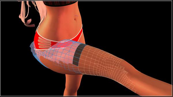

    edited May 2014

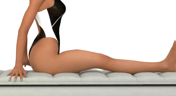

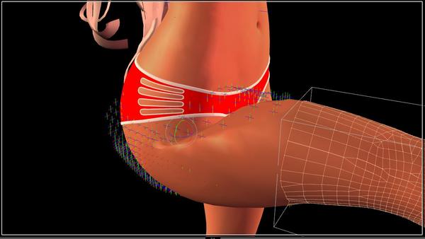

    worked on the issue some more !
    that's the target shape for the morph
    the thigh-top arcs were modified to end at the bikini uh arches
    the thigh side bend arcs need to have a larger radius i think
    in real live the acute folds begin about mid-way
    ( mcjTeleblender export followed by Blender Cycles render )
    figure 2 i may also do something for the underside
    1920 x 1200 - 513K
    1920 x 1200 - 342K

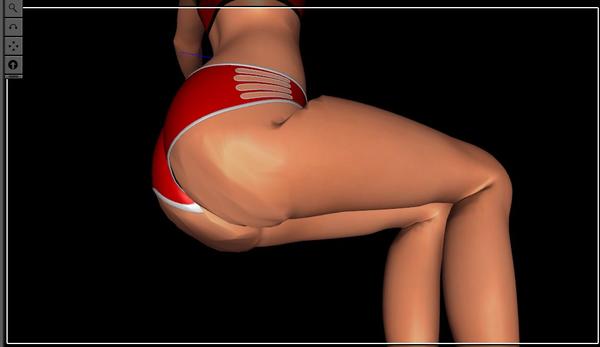

    edited May 2014
    a few hundred tweaks later
    some of it on the sides near the bikini "gills"
    so the acute-angle skin fold begins closer the the middle
    1920 x 1200 - 186K
    1920 x 1200 - 1M
    1920 x 916 - 268K
    1920 x 1200 - 255K
    edited May 2014
    back of the thighs substantially pushed up
    next time i get back to this project i'll build the morph from this "sculpture" and post it on my site !
    1920 x 1200 - 982K
    1920 x 1200 - 527K
    edited July 2014
    it's not perfect, but it does de-flatten the thighs and gives mildly accemptable results :)
    1200 x 758 - 378K
    1200 x 758 - 379K
    1200 x 758 - 562K
